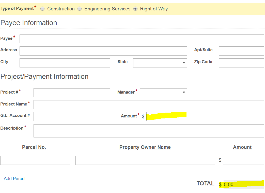

JavaScript to check that two fields are equal
posted on March 11, 2020 • Show version history
I am wanting to verify the TOTAL and Amount fields are equal only if the Type of Payment is "Right of Way" (.paytype).  The TOTAL field only shows if "Right of Way" is selected.  I found some helpful JS on LF Answers, but since I don't have anything checking to see if the Type of Payment is Right of Way it runs even when the TOTAL field is hidden causing the submit button to disable.  Could someone please help me fix the JS below to only run when Type of Payment (.paytype) equals "Right of Way"?

replied on March 11, 2020 • Show version history
If you have the "Type Of Payment" radio button with CSS class '.paytype' then you just need add a check into your if statment.
Change
if($('.rowtotal input').val() != $('.payamount input').val())
into
if($('.paytype input').val() == 'Right of Way' && $('.rowtotal input').val() != $('.payamount input').val())
replied on March 12, 2020
Hi Alistair,
Thank you for your response.  I tried what you put above, but when I add it to the JavaScript the custom error message and submit button disable do not work.  Below is what I have.  Am I missing something?
hmm, I can't see the issue looking at it there tbh. Could you send me a copy of the form? (It would just make it a little quicker to troubleshoot). In forms, go to the "Manage" tab, tick the process and press the download button in the top right. Then send me the xml that gets downloaded.
replied on March 16, 2020
Hi Alistair, I have downloaded the xml file, but I am unable to upload it.  What is the best way to get the file to you?  Thank you for your help.
