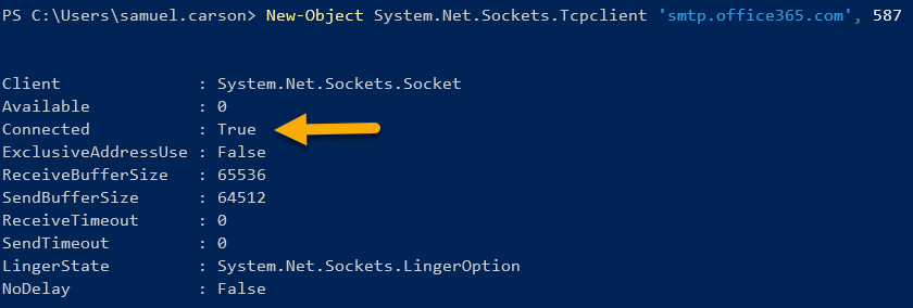

  • Run the following PowerShell command from the Forms server to verify outbound network connectivity to smtp.office365.com on port 587:
    New-Object System.Net.Sockets.Tcpclient 'smtp.office365.com', 587
    If successful, you'll get a result like this:
    If unsuccessful, you'll get some "connection failed" red error text instead. If that's the case, you'll need to open outbound firewall rules for port 587 (or work with your IT to do so).

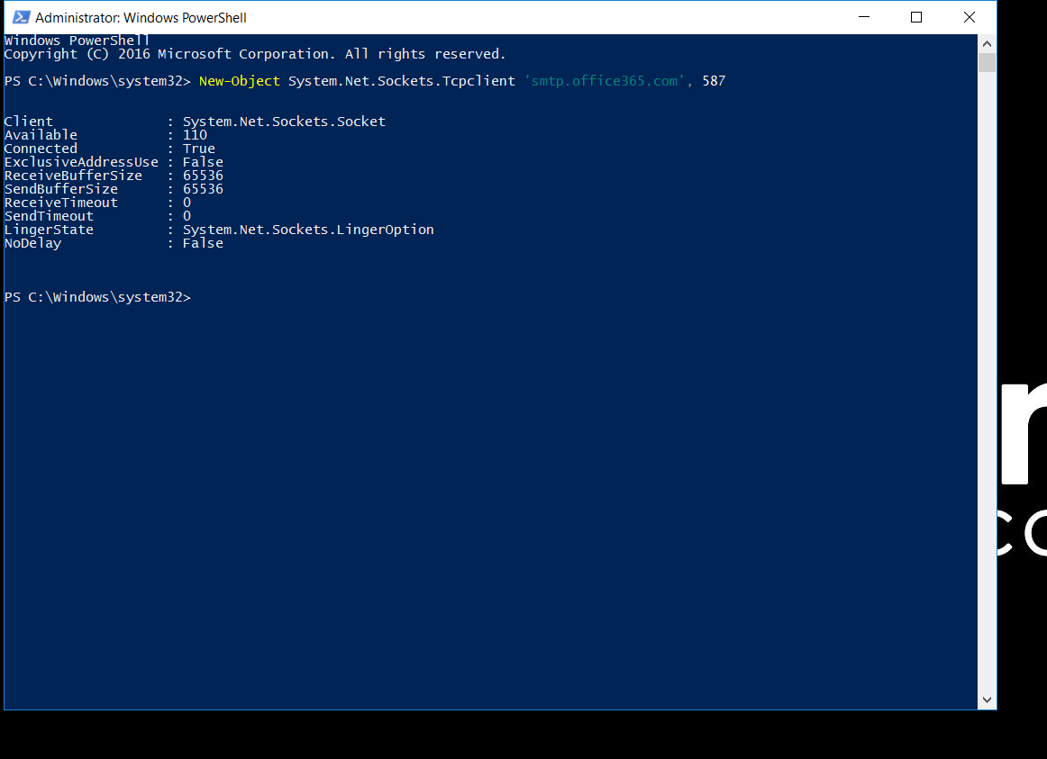

replied on April 7, 2020 Show version history
@████████ Ok...My IT team finally tried this and this is what they got. They asked if they needed to look somewhere else possibly?
Looks like the port is open then, assuming they ran that command from the Forms server.
What about the first two bullet points?
