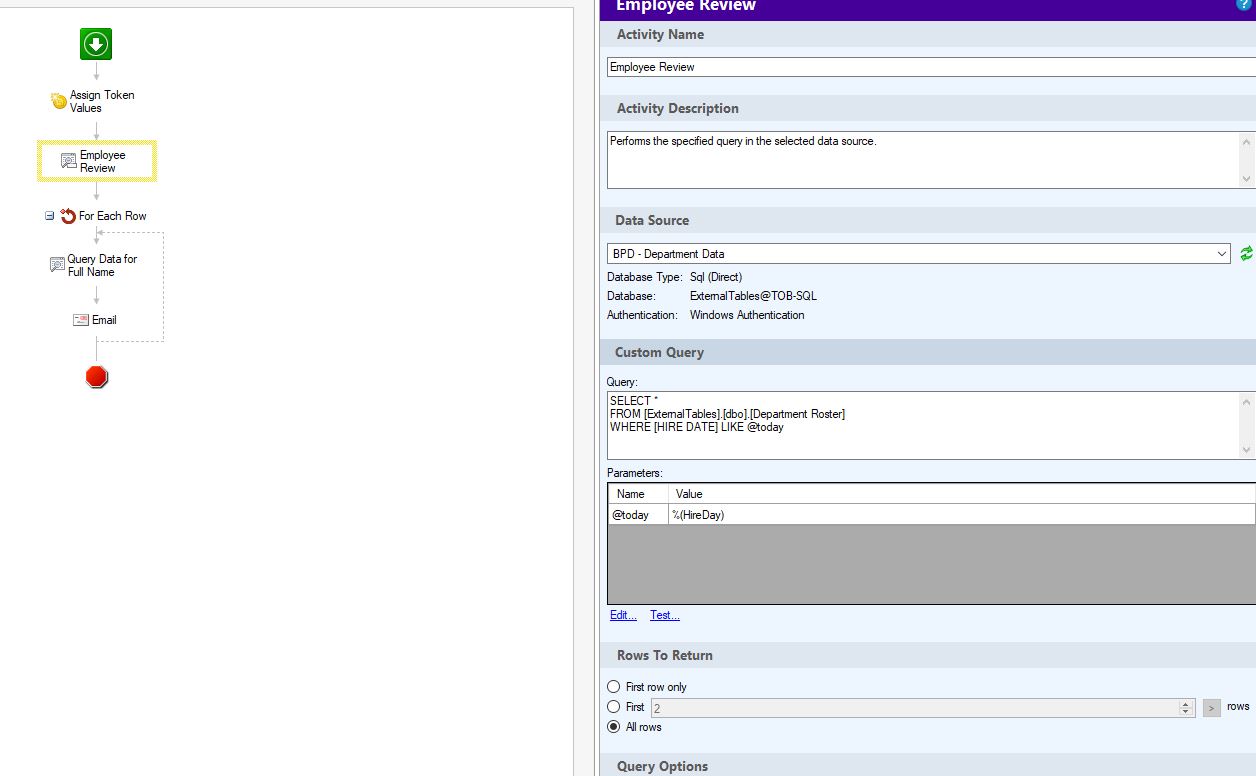

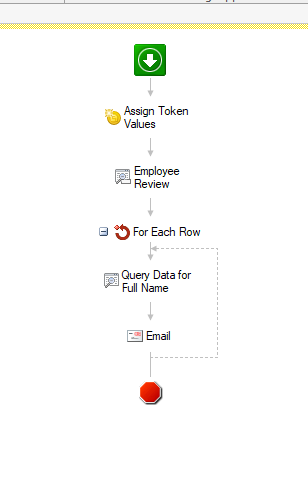

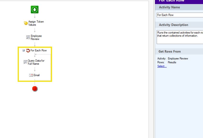

This workflow worked 2 weeks ago.  I'm not sure if I broke it or it was system administrator that recently changed some naming terminology on the external tables.
The workflow is suppose to query employees in an external database and find the employees hire anniversary date excluding the year.  So I was hired on 9/22/1997 so on 9/22/2020 an email is sent to have them review their information on file.  9/22 has to equal 9/22 of any year.  There could and is more than one employee on any given day.
It doesn't get any results from the "Employee Review" query so it never does the "For Each Row" activity.  I have been messing with it all morning with no luck.  Any help?

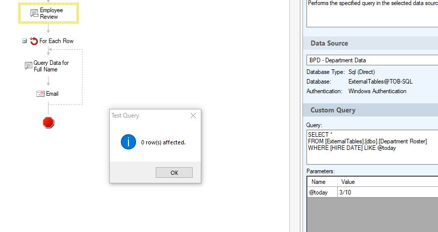

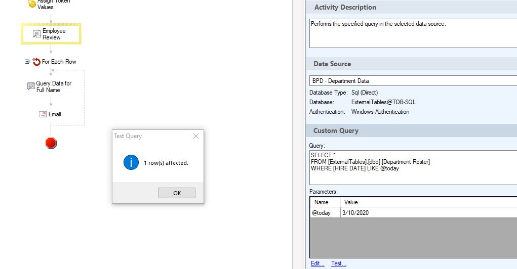

The dates are selected from the date picker on a LF Forms and are stored as M/DD/YYYY or MM/DD/YYYY.

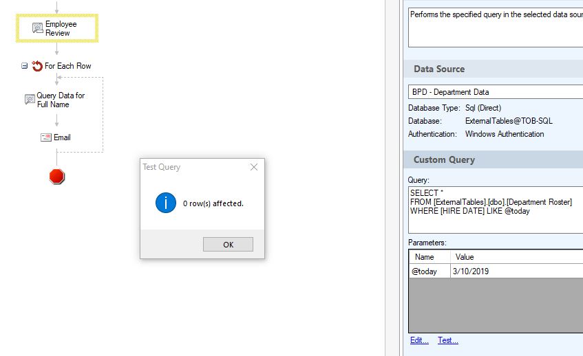

When I replace the HireDay token with todays date I return one record like I should (See pic).  But when I change the year to the previous year it returns nothing and yet it should return the same record since the month and day match (See pic).  I also when I add a leading zero in from of 3 (March) nothing returns.
My Hire Date does return the value of 3/10 and were using the LIKE when this workflow was working fine for over 6 months.

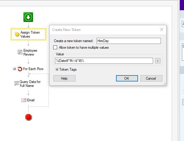

The reason I was asking what data type was used on the SQL side is that date and datetime are formatted in a standard way no matter how the date was sent over. For example, if you store 01/20/2020 as a "date" type, it is still stored as 2020-01-20 in SQL.
However, the fact that any of your queries worked in testing suggests that they're being stored as string values (not necessarily best practice), but that would be why the "LIKE" queries worked at any point.
Second, "LIKE" is not a partial comparison by default, you need a % symbol to act as a wildcard for it to work the way you expect and that was missing from your second round of tests.

'3/10/2020' LIKE '3/10/2020' -> TRUE
'3/10' LIKE '3/10/2020' -> FALSE
'3/10%' LIKE '3/10/2020 -> TRUE
Note that in your original screenshots the % is added to the end of the "HireDay" Token itself, but you did not have it in there when you tested 3/10.
Try testing '3/10%' instead of '3/10' and see if you get different results.
Also, I'd recommend adding the % in the query, not in the token value, that way it is easier to notice it should be there.
You could add it to the end of the "parameter values" or you could build it into the query itself so there's no way to forget it even in testing, like so,
WHERE [HIRE DATE] LIKE CONCAT(@today,'%')
Then your Parameter Value for @today would just be %(HireDay) and you could remove the extra % at the end when setting the HireDay token.
replied on March 10, 2020
Yep you were right!  I tested 3/10% and it returned a record.  I added the wildcard behind the token in the Parameter Value and the workflow worked correctly!
I still wonder way it worked before and broke.  I had that wildcard in the Token itself.
