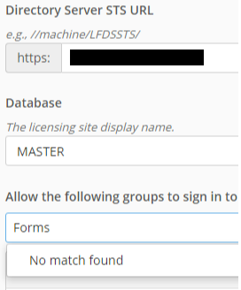

Forms Config - Sign on with Directory Server unclear inputs
posted on March 5, 2020
Is this first field asking for the address of the Directory Server or the STS login site?
If it is asking for the STS login site, and never asks for the Directory Server address, how would it ever find groups within Directory Server without knowing where it is located?
replied on March 5, 2020
It very specifically says "Directory Server STS URL" and provides an example with the LFDSSTS endpoint. Enter the STS login site you want Forms to redirect to for authentication.
