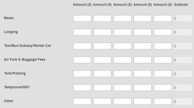

I've been looking around and haven't seen this asked so hopefully this isn't a repeat question. I have been working on an expense reimbursement form for my company. Currently, I have it set up so I have 3 different tables for people to enter their expenses to in case they need to be split or billed to multiple clients/jobs. I used the Laserfiche help section to get each table to have its own subtotal using JavaScript.

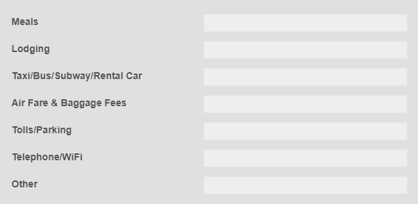

What I would like to do, however, is to add these subtotals for each row into a final review table that is separate from the other 3 tables.
I do have fields to give grand totals at the end, but it would be nice to have the breakdown in the separate categories as a final review for anyone submitting.

First off, to make things as easy as possible, make sure that each of your 3 tables have the categories on consistent rows. For example, make sure that Meals is always in row 1, Lodging is always in row 2, etc.
Next, you'll want to have the category totals as single line fields, each with their own formula following this structure:
=SUM(INDEX(Table_1.subtotal_column, 1), INDEX(Table_2.subtotal_column, 1), INDEX(Table_3.subtotal_column, 1))
In the above formula, the "1" is the row for that category, so if Meals was consistently in row 1, the above formula would return the sum of all three subtotals for Meals. You'll need to update this number for each of the categories depending on which row they are in (2 for Lodging, 3 for Taxi/Bus, etc).

Let's try something else.
Create a new table for your category totals with a fixed number of rows and one column. In the column's Field options, go to the Advanced tab and use this code:
=SUM(INDEX(exp_info_1.Subtotal_1, ROW()), INDEX((exp_info_2.Subtotal_2, ROW()), INDEX(exp_info_3.Subtotal_3, ROW()))

replied on February 27, 2020
No problem! We'll get to the bottom of this.
Try the following steps:
  1. In the Forms Designer, click on the first user input table
  2. Click Edit
  3. Click "Field options" for the column that has the subtotal
  4. Copy the variable field
  5. Click on the category totals table
  6. Click Edit
  7. Click "Field options" for the column
  8. Open the advanced tab
  9. Paste the copied variable into this formula:
    1. =SUM(INDEX(exp_info_1.PASTE-VARIABLE-HERE, ROW()))
  10. Save and preview the form
  11. Insert amounts into the first table and see if they show up in the category totals table.
This should work for getting subtotals to populate from the first table only. Let me know if this works and we can get the totals from all of the tables next.
