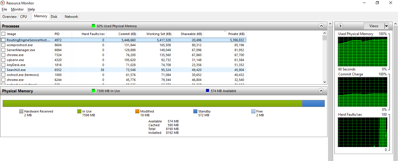

routingengineservicehost.exe eats up all my RAM space when i start the Laserfiche Forms Routing Service
asked on February 20, 2020
Please find attached a screenshot of the space eaten by just the routingengineservicehost.exe process in the Resource Monitor. Not sure what is causing this anomaly. I have stopped the service because, if it's running, it takes about 5mins to load a forms page and the whole server becomes slow. Very disturbing.
Can someone assistance please?

Created a task with a 1hr reminder to the task owner's superior after task deadline. When the task got to that stage, it was ignored for weeks as we were just testing and it kept sending email reminders per hour and going back to sit on same task without interrupting the task. In such a case, does the task need to be interrupted?
replied on March 5, 2020
Yes, if you have a timer boundary event attached to a user task, if the flow out of the boundary comes back into the same user task, you need to set it to interrupt. That way, when the timer hits, it will cancel the in-progress user task, then create a new one. The way you had it set up with not interrupt will leave the initial user task then create a new one each hour. The assignee would then have 2 after the first hour. If you have the timer set to repeat, now both user tasks are on the clock. After an hour, the timer hits for both and 2 more get created. Now you've got 4 user tasks and repeating timers... Exponential growth is no good and would definitely cause this behavior after a few days.
