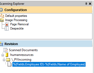

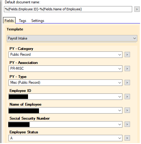

I open Laserfiche scanning to add documents with the template as show and enter in the top four fields.  The Name, SSN and status are all related to a database table associated with the Employee ID.
I scan the document(s) and the data represented by the tokens is displayed in the revision pane.

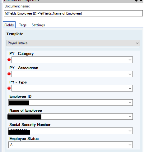

But after the document is scanned the fields are blank again waiting for metadata to be entered, as denoted by the required metadata error symbol.

It looks like only certain fields are clearing while others stay filled. Is that correct?
replied on February 19, 2020
Laserfiche Scanning 10.3.1.306
These fields are stored in a table in a SQL database.  The information in these fields clear, but the others are being pulled from information stored in PeopleSoft.  I have other templates that don't have this issue, but they are pulling from a different table.
