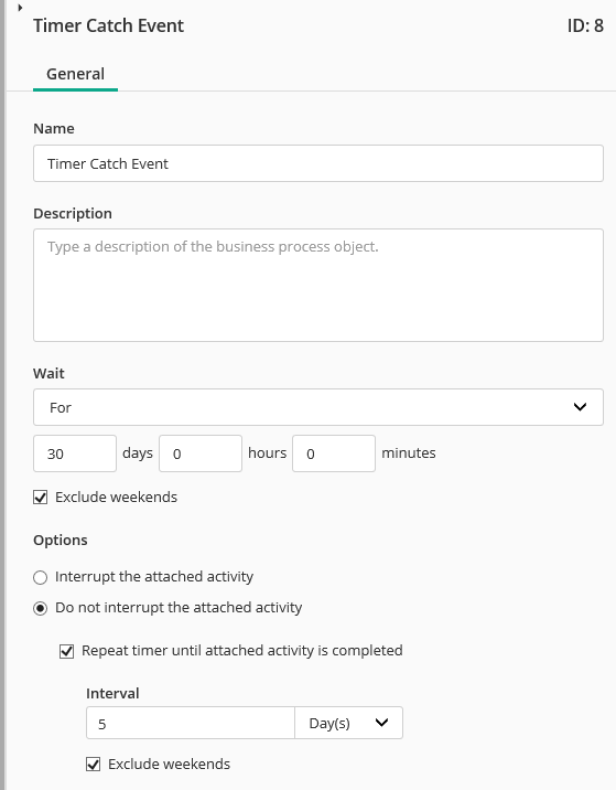

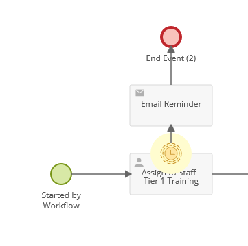

We did the update to Forms 10.4.2.381 over the weekend and since the update any existing time catch events are triggering 12 times.  These were all working properly and only triggering once before the update.  Any suggestions on this?  Thanks

We fixed an issue(230937) for repeatable timer in 10.4.3 Update 1(https://support.laserfiche.com/kb/1014151/list-of-changes-for-laserfiche-forms-10-4-3-update-1):A repeatable boundary timer no longer executes multiple times when there is an in progress timer catch event that should suspend when upgrading from 10.4.1, and after the routing engine is restarted.
You can install Forms 10.4.3 then apply the Update 1, or upgrade to the coming Forms 10.4.4 which will be released this month.
