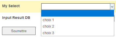

I created a lookup table from a select ("My Select") to autofill an input ("Input Result DB").
"My Select" default's value is empty

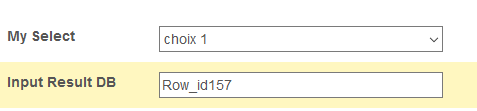

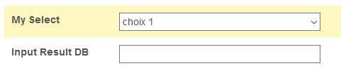

I wish to auto fill "My Select" using URL and Javascript (...?MySelect=choix_1), then get the result from the lookup table in the field "Input Result DB" but my lookup table doesn't work like this.
I need to change "My Select" manually to get the value in the field "Input Result DB".

You need to trigger a change event on the select field, which can be done easily with jQuery's .change(). So for example, if the drop-down is q1, then
$("#Field1").change();
after you've changed the value will trigger the lookup rule.

Thanks Jim,
It's working.
