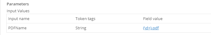

I tried using the regular expression in the input parameter but it did not work. I also tried to assign EntryName with the value of (\d+).pdf before my Run Rule and that did not seem to work either. I know I'm missing something silly.

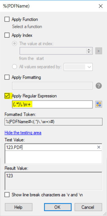

In your workflow where you want to get the name without the extention, you would assign the token where the data is - like %(PDFName), but then you right click on the token and open the Token Editor.  In the Token Editor you have the option to apply a Regular Expression as well as test any applied modifications.

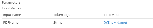

I tried to assign a token of EntryName as  a string to the beginning of the Workflow then on the Run Rule function, I did below.
I did do a right click and assign regular expression. I am missing something.

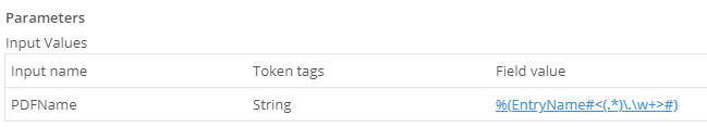

I got it to work! Thank you both for your help!
