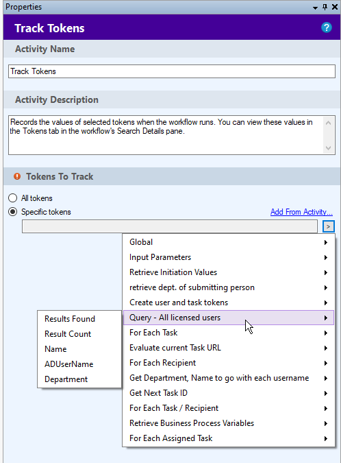

For the purpose of trouble shooting. Can I view the values populated from my data query.
When I test my data query. I get a positive response that my lookup value passed was found.
But the query does not return all of the data I am trying to pass to my template.
Is there a troubleshooting method to see what data is being returned.?
replied on February 7, 2020
Unfortunately, not in the same way that a DB Editor would give you. You can set the query, add a track tokens tool to the WF and set it to only track what it gives you from the query. Like in the picture below:
It's a little more lengthy though than just having a DB Editor (SSMS is Microsoft's free SQL editor) and putting your query into that to see what comes back. But natively inside Workflow itself, this is the only method I've found to be able to get that result it comes back with. I wish I could give you more to go off of.
