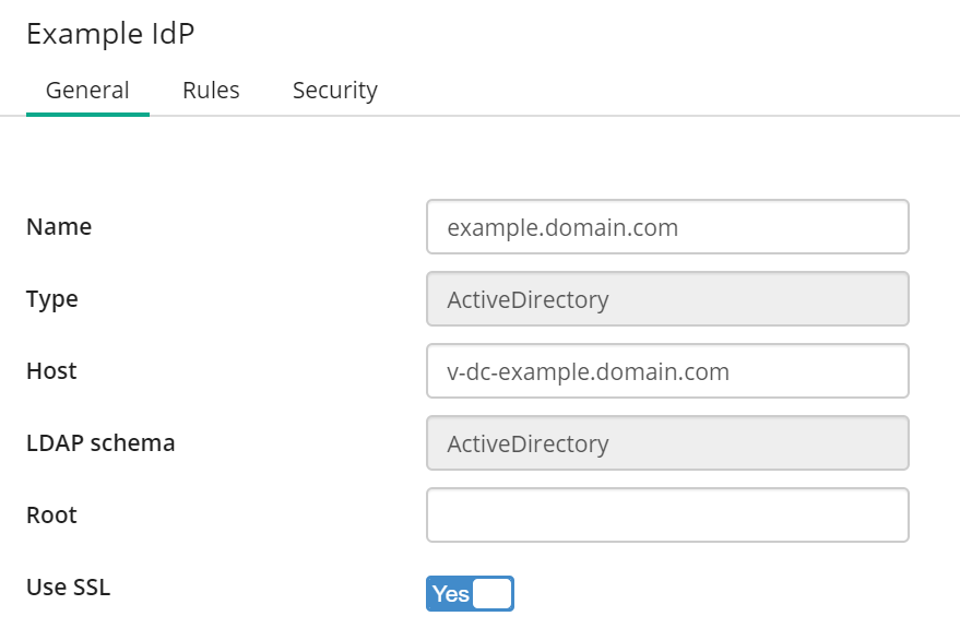

For Directory Server, have you enabled the "SSL" option under the identity provider settings?
That should force it to use LDAPS (encrypted LDAP) instead of unencrypted, as long as a certificate has correctly been configured on the domain controller to support LDAPS.
replied on February 6, 2020
Hi Briana,
I don't believe it's been set quite yet, no. Would this cause all of the other applications to also use that though, such as Forms and Laserfiche server? I'll get that set for the Directory Server regardless since that's a big part of those connections.
Thanks!
Cody

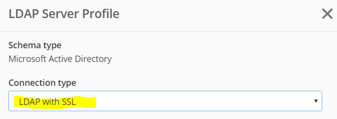

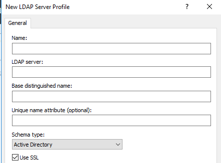

No, it would not affect other applications' communication with the domain controller.
If you have LDAP profiles for the Laserfiche server, there is an SSL option:
If you are using Directory Server for Forms authentication, I don't think Forms needs to have LDAP settings configured.
If you are using repository authentication for Forms and have LDAP Forms Authenticated Participants, you can set LDAP to use SSL from the "System Security" page under Forms Administration:
I'm not sure what other settings you may need to adjust, but I'd start there.
