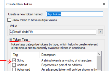

Also, In the Assign Values where you assign it to the custom token, check your Token Tags and ensure String is checked and no others. This will ensure the output is treated as a  String Value

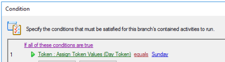

As far as your condition goes, it show look as you expected
