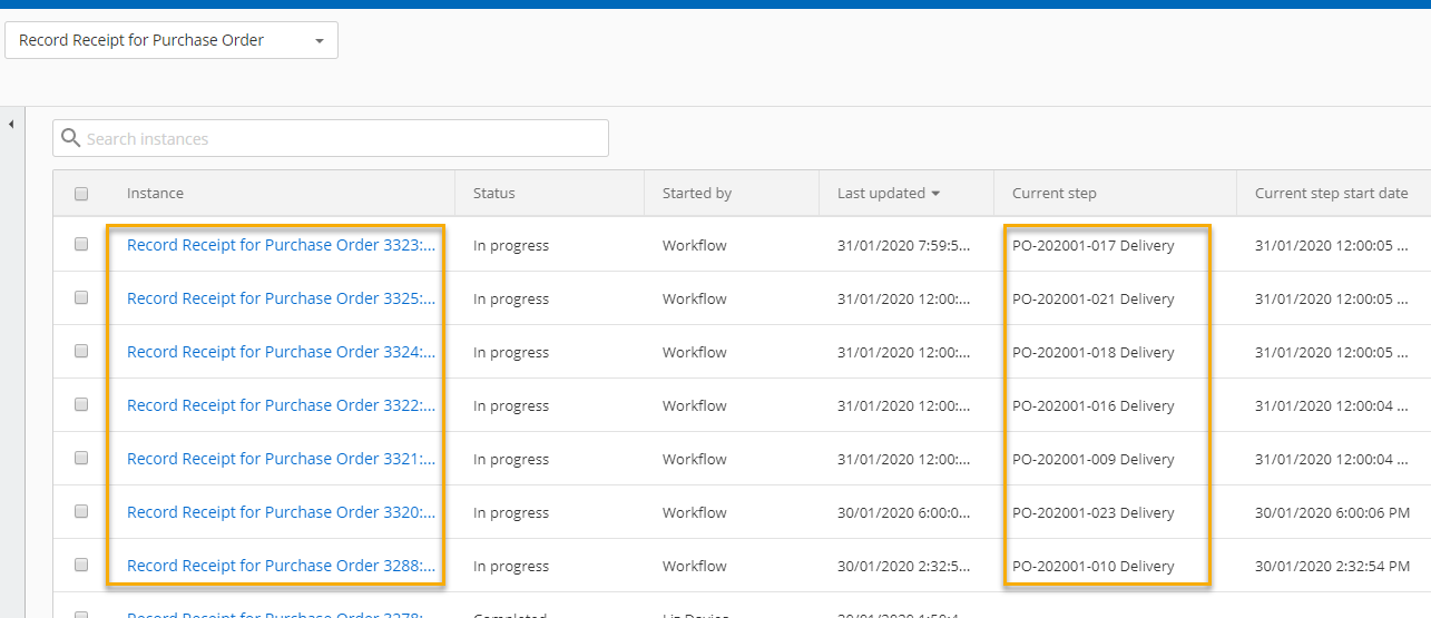

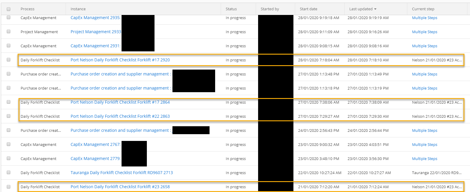

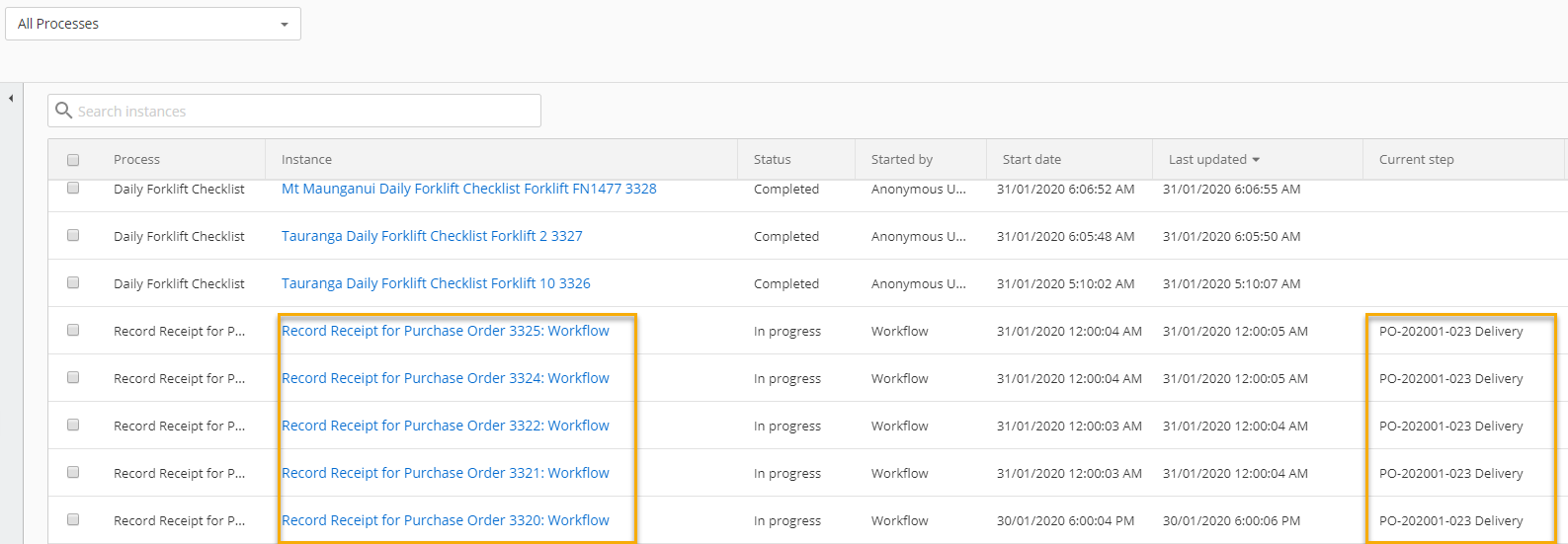

I would like to raise an issue on the name of the current step in the Monitor tab.
If we apply no filter by process, the current step name is the same for the same business process, as you can see on the first screenshot. The business process is Record Receipt for Purchase Order. For the 5 instances, the current setp name is PO-202001-023 Delivery which is only correct for the Instance 3320.
If I choose to filter by Processes, then the current step name displays correctly (second screenshot).
Same behavious has been noticed for other processes.
Thanks
Veronique

Regarding this issue, please upgrade to Forms 10.4.2 or higher. From reviewing the details, this sounds like a bug we had already fixed.
Bug 154487: When using variable token in the step name, it always shows the step name of the first instance for all instances of the same process when monitoring by all processes

Hi Liyun, attached is another screenshot from the Monitor tab for another Business process. This one is a public form and does not start with a workflow. As you can see, all 4 have the same current step name, which is only correct for the one at the bottom.
Would you still like me to send a process XML ?
Thanks !
