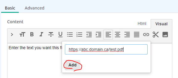

If this works, on your form, create a Custom HTML field, click the URL button and add the documents URL you just tested into the field which will create a hyperlink on your form when you press Add.
Test the Hyperlink and the file should open
