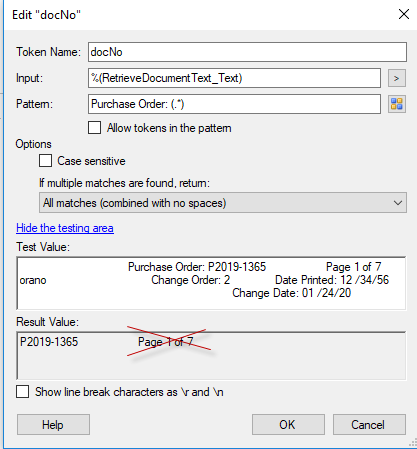

By the way I had an error in my original, this might be simpler for you:
Purchase Order: (.*)
replied on January 29, 2020
How do I get rid of the text that follows? Anything after the next space should not be part of the result value.
replied on January 30, 2020
Purchase Order: ([\w\-]*)\s*
This says "Once you see the block of text, 'Purchase order: ' capture 0 or more word characters* and any hyphens after it until either the text ends or until you hit a space. Don't capture that space, and stop capturing once you get to it"
*word characters are a-z, A-Z, 0-9, and _
