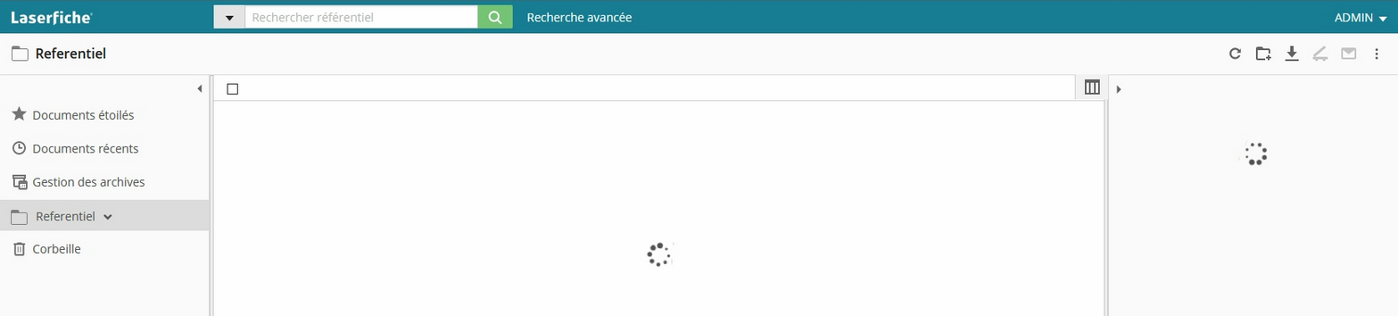

3. No, the external users don't need to connect directly to Laserfiche Server, they only need to connect to repository using Web Client. But actually they can't use the Web Client because the elements are loading in loop. They don't see anything.
