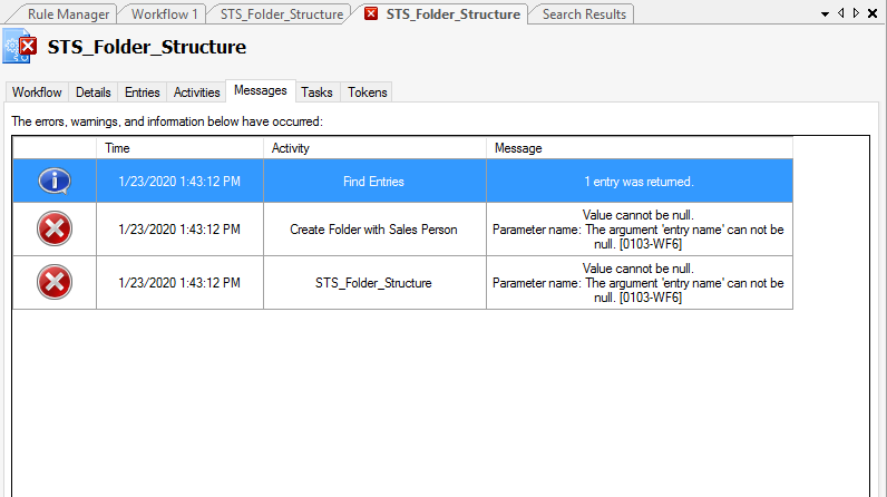

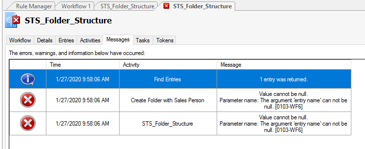

I am importing an xml file with import agent 9 into Laserfiche 10.4.1. A workflow is to pick up the xml and populate a template. I receive the error "Value cannot be null. Parameter name: The argument 'entry name' can not be null. [0103-WF6]"  However if I open my xml all the fields are populated, also if i manually drag a file into laserfiche and populate the fields the workflow runs as expected.  It seems to not be able to read the xml. I will attach a sample xml file that my workflow can't read.

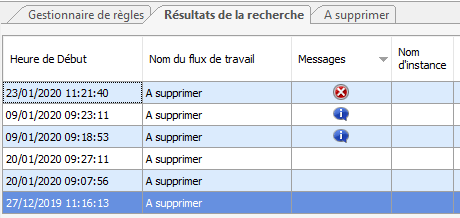

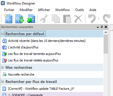

Please open your Workflow Designer , then go to the Window "Current Search".
Select your workflow and find the last one with the error message.
Double click on and see where is the error.
Copy/past a print screen.

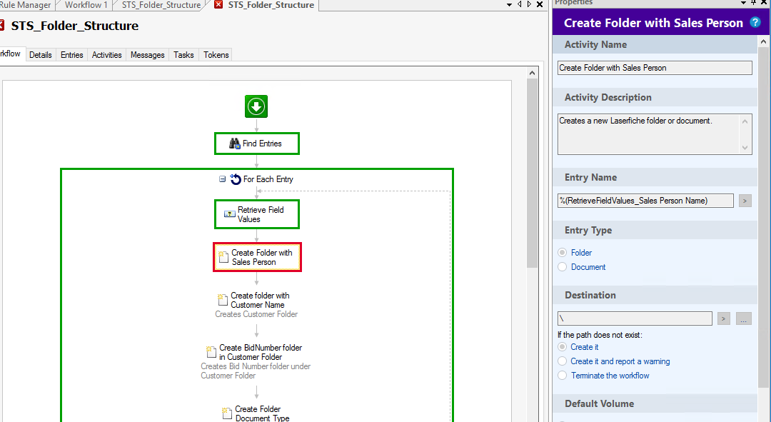

Hi Olivier, Thank you very much for replying, I am attaching a screenshot of my error on WF activities. The WF does work correctly if i manually drag a file into laserfiche and fill out the fields.  It only errors when I import the xml file from import agent. But when i view the xml file all the fields are there but WF is not picking them up.  This all worked fine before I moved Laserfiche to a new VM. Also when I moved LF i did upgrade it from 10.2 to 10.4.1.  So I'm wandering if something changed in with upgrade. I did not upgrade import agent that is version 9.0.0.  Any advise would be appreciated.

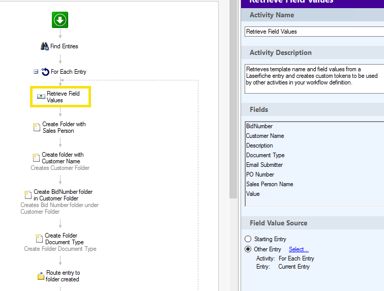

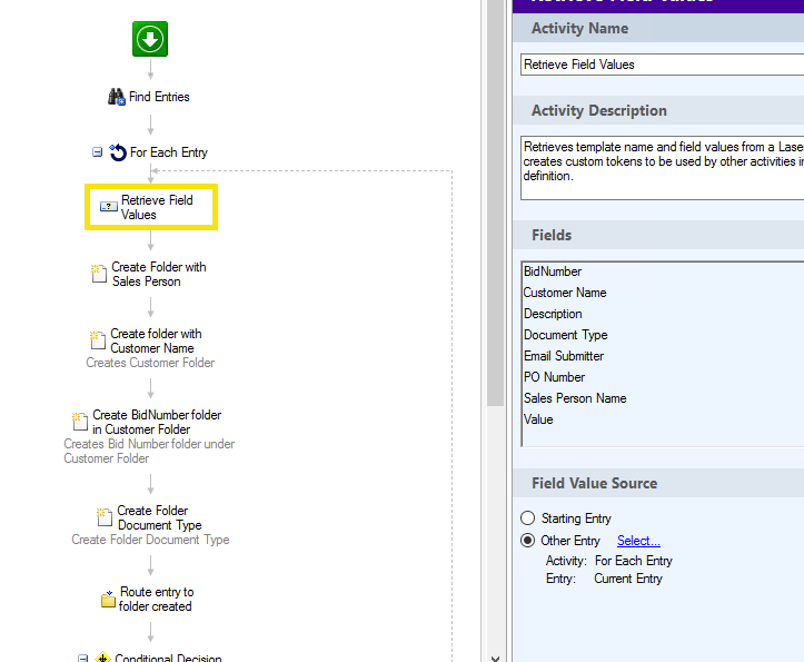

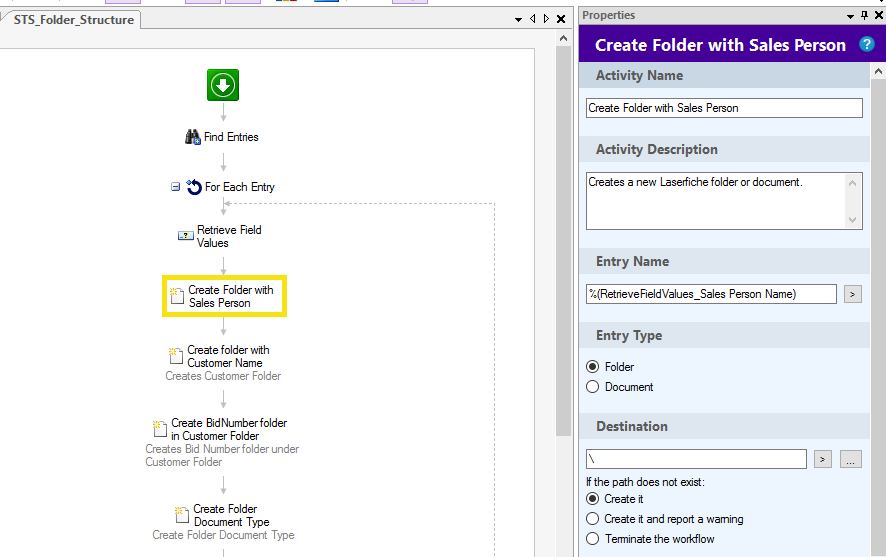

You said in your original post that a workflow is to
The workfolw image above is retrieving the field values and creating folder structure.  Do you have another workflow that does the field population?  If so, that workflow needs to run before the workflow shown above.

Hi Bert, thanks for the quick reply.  I do not have another workflow that populates the fields. I don't understand as this workflow worked in LF 10.2  did something change in 10.4.1?  The workflow retrieved the field values from the XML and populated the fields and created the folder structure.  The xml is being pulled into Laserfiche by import agent I have attached a sample xml.   This all worked before the 2 things that changed are LF was moved to a new VM and was upgraded.
