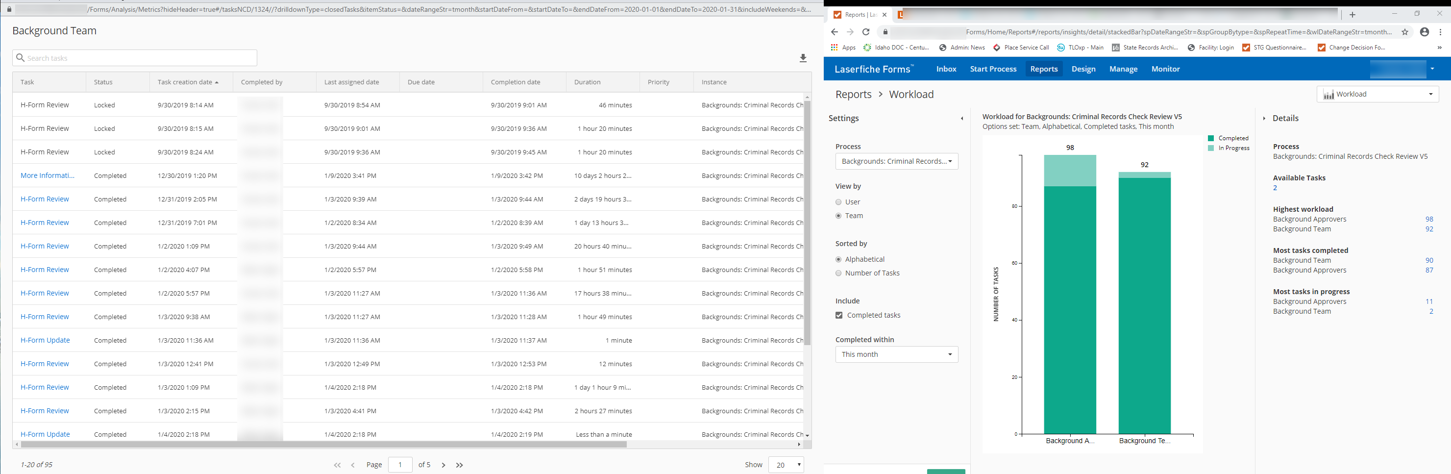

This one was the Workload report (see attached screenshot). If we close out of the instances list and then reopen the "locked" instances will be back to normal (completed/in progres...) and the August instances will be gone. Sometimes we have to close/reopen a couple of times before if is corrected.

Sorry, attached screenshot here.

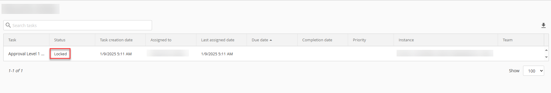

I just ran across some more instances today that had a status of locked. I took a screenshot that shows they have been locked since 1/9/2025 (last assigned date). It would be extremely helpful if there was a built-in report to find these or process to take care of them automatically.

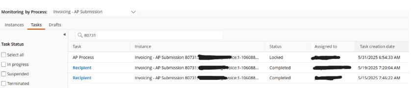

What is the numeric value of the locked status in the database?
How do I run workload report on all instances filtering by locked status?
How do I get notified when a task enters locked status permanently?
If the user has already completed the task, rather than restarting it, how do we move the process forward?

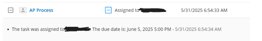

Why do the processes show In Progress and the Tasks Status in the process just shows Assigned if it is actually locked?
Process Tab
Tasks Tab
