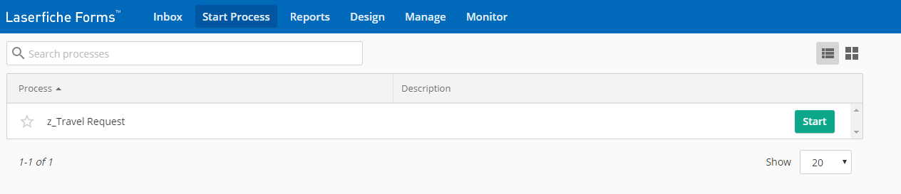

replied on January 22, 2020
Okay, but to clarify, is this a published form being accessed via the published URL, or are they clicking the "Start Process" button from within Forms?
They can log-in to forms and click "start" to start the process or click the link we have.
Either way, the script to scroll to the section does not work.
