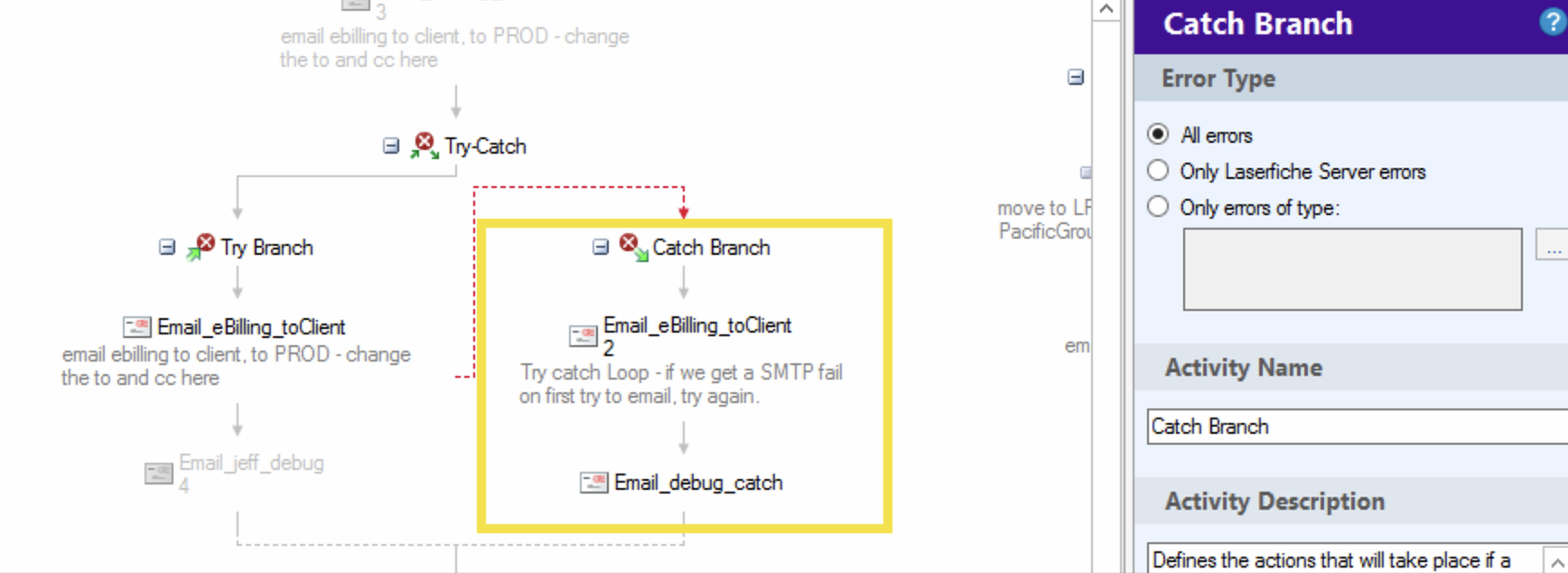

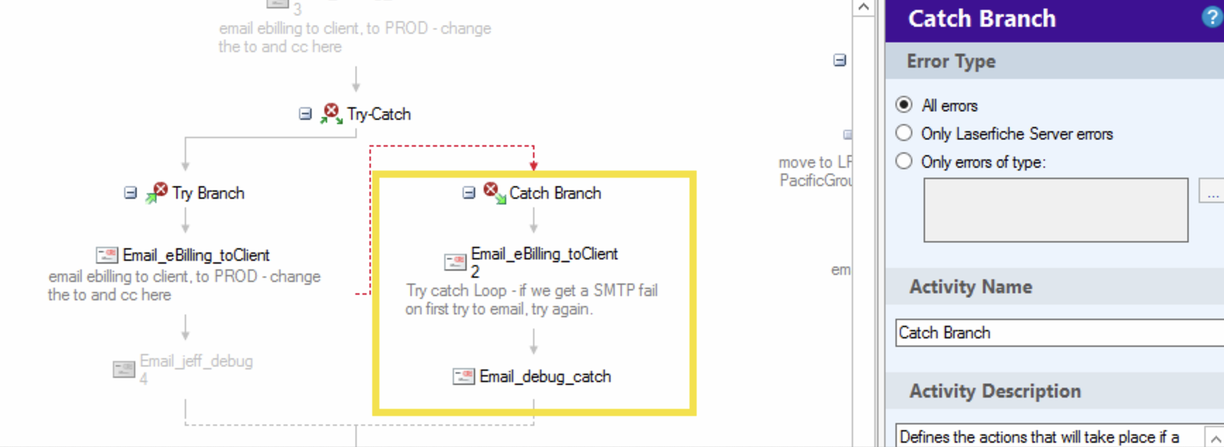

replied on February 20, 2020
Hi Omar
See screenshot of workflow.
In the try branch we have the email SMTP send task, if that works it just send the email and all is good.
In the catch condition we watch for any errors, as selected in the screenshot, so a SMTP timeout is an error and that triggers the catch branch - we then resend the email that timed out, and send an email to the developers (the debug email) with the fact that the catch branch triggered.   As we have just the one task in the try branch this has been working well.
It would be nice if I could trigger on a specific error, but we tried some ideas there and didn't make much progress.
Jeff
