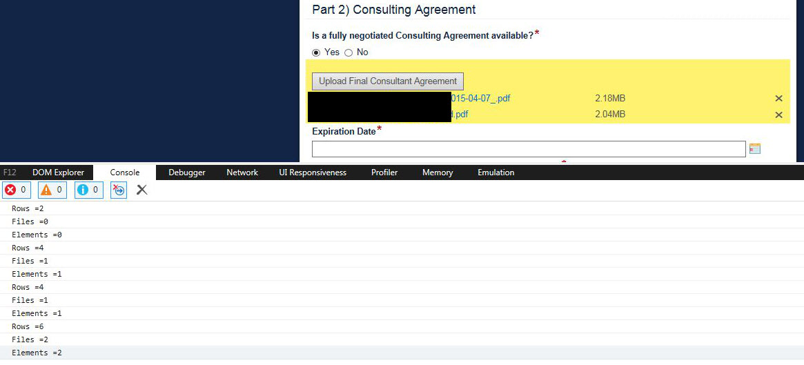

Can someone explain why the table structure of a file upload button is different in Preview Mode than it is when you actually start the process?
We discovered this when trying to count tr elements in the file upload table to get the file count. We developed the solution in preview that required us to divide the number of rows by 2 and subtract 1 to get the actual number of files, but when we moved to actually running the process the count was no longer correct. The table structure was significantly different.
Can someone explain why?

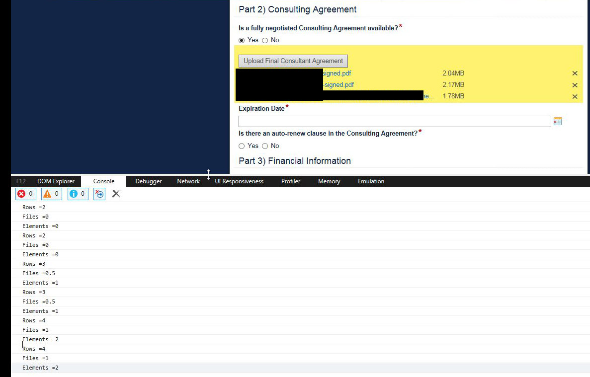

The code we were using when we came to this conclusion is here:
$('.MyTable').on('change blur', function() {
        var rows = $('.MyTable tr').length;
        var files = (rows / 2) - 1;
        var elements = $('.MyTable .file-del').length;
        console.log('Rows ='+ rows);
        console.log('Files ='+ files);
        console.log('Elements ='+ elements);
        $('#q79 input').val(elements);
        $('#q23 input').prop('required', true);
Now that I fiddle with it some more, it appears that it is more about the timing of the calculations. In preview, I'm seeing the file upload almost instantly. So the calculations happen after the table has added the row for the file. When we run the process, the files actually upload therefore taking longer for the table to update and the calculations are premature and finish without the new file included.
