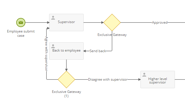

Sure, you can build that into the process. Below is an example where the employee first submits a case to their supervisor. The supervisor can approve it or send it back to the employee. If the employee agrees with the supervisor, they can update the form and send it back to them. If the employee disagrees with their supervisor, they instead can send the form to the higher level supervisor. You just need to provide buttons on the user tasks to give each person the option of where to send it next.

Thank you both! Right now we have it set up as Jared suggested, but we may look into adding the workflow part after testing. We are just getting started with Laserfiche forms and workflow, so we have our work cut out for us!
