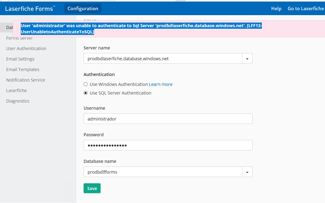

We are installing a test environment on ms azure for the customer they are using azure database service. LF Server and WF are working fine and they connect to the db with no problem at all. We are using only one db user. When we try to configure Forms we entered the db server and the db user then it lists the available dbs, we select the one we need and when we clic the Save button it shows the following message:
"User 'db_user' was unable to authenticate to Sql Server 'prodbdlaserfiche.database.windows.net'. [LFF13-UserUnabletoAuthenticateToSQL]".
'db_user' has db_executor and db_owner permissions.
Anybody that can help us with any ideas about what could be the problem¿?
Do LF Forms support that kind of azure db services¿?

Laserfiche Forms supports Azure SQL Database as of version 10.4.2, released December 2019. What version of Forms are you using?
If you're using Forms 10.4.2 or higher, check the following:
  • Make sure your database server name is correct. I see you have "bd" instead of "db" in the name. Not sure if that's correct for base de datos or a typo.
  • In your post you say the account "db_user" has the correct permissions, but your screenshot shows the username "administrador". Which is the right one?
  • Look in the Forms Event Logs for the actual error message from the SQL driver rather than the one Forms shows in the UI. It may have additional useful information. This one is key to identifying the true issue. Please respond with any event log messages related to SQL that you find and we can assist from there.

Hi Samuel, thanks for your answer.
Answering your questions...
- Version 10.2.1. Rio Installer.
- Database name is correct.
- We tested with two users so I just typed 'db_user' as an example.
This is the error in the event viewer for the forms operational log:
[13]: User 'user_laserfiche_new' was unable to authenticate to Sql Server 'prodbdlaserfiche.database.windows.net'. [LFF13-UserUnabletoAuthenticateToSQL]

replied on January 16, 2020
Samuel, thank you so much for your indications. After installed Forms version 10.4 the connection to the azure db service was successful.
