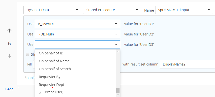

replied on January 8, 2020
Sorry for the late reply.
I tried to create a stored procedure as follow:
CREATE OR ALTER PROCEDURE [dbo].[spDEMOMultiInput]
	@UserID1 nvarchar(30),
	@UserID2 nvarchar(30) = NULL,
	@UserID3 nvarchar(30) = NULL
AS
BEGIN
	// details omitted
END
GO

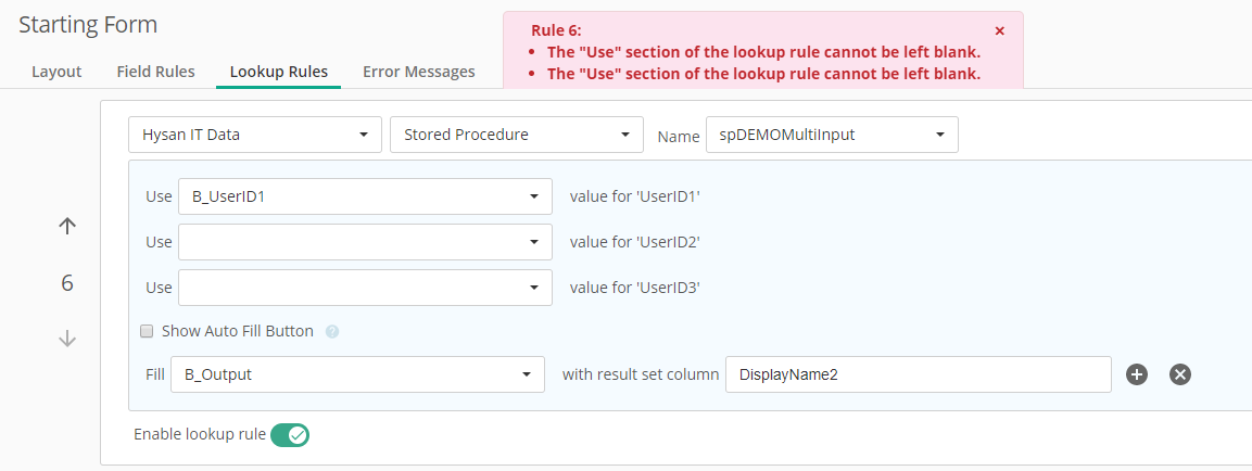

When I setup Lookup Rules, it shows "The "Use" section of the lookup rule cannot be left blank." when I leave the parameters empty (as shown in screenshot 1 below).  When I try to use _DB.Null, it only allows me to use once only.
Thanks.
