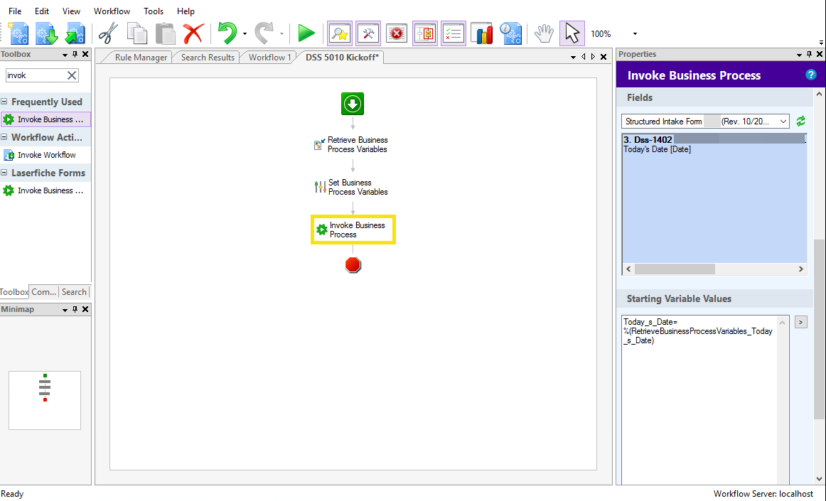

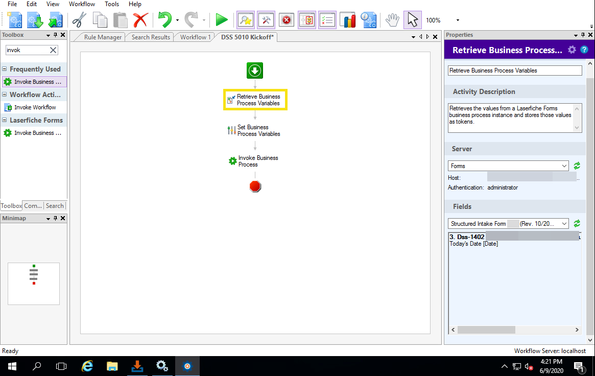

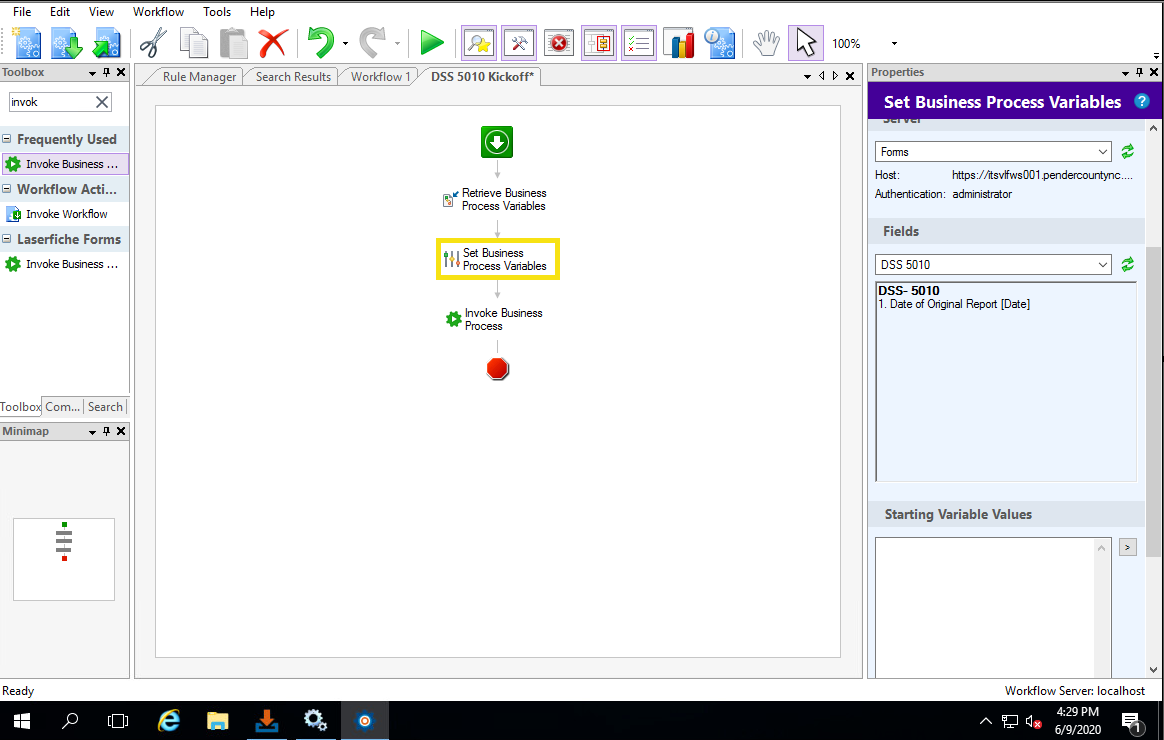

replied on June 9, 2020
Thank you for responding so quickly!
Right now I have it set up so that I will be invoking the Business Process in the beginning of the second form's Process Designer- Or should I put it at the end of the Process Designer in the first form? I apologize as I'm not sure about best practices. Could you tell me if I understood you properly by looking at the Workflow Screenshots attached?
You have been incredibly helpful with this; the main issue is that this is the first time we've tried to put this to the test in our environment.
