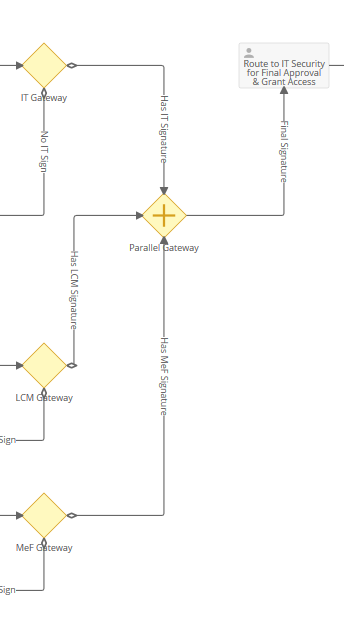

In my process diagram I send 3 different user tasks to capture 3 different signatures. Due to variable selections it could only require 1 or 2 or all 3 signatures.
Once, they have been signed I want to send ONE Email user task for a final signature, but instead it sends an email for each signature received to the same Final approver.  How do I merge many to ONE?  I have tried the Inclusive Gateway Merge and get an email for each signature captured.  Then, I tried the  Parallel Gateway Merge, and it stops and doesn't send the Email task at all if All three signatures are not captured.
Below is an example of my diagram for this section: (this example shows a Parallel gateway, taking 3 inflows into 1 outflow. Each signature flow is only active if the variable was checked in the beginning resulting in possible outcomes of 1 signature required, 2 signatures required or all 3 signatures required.  Is this a condition issue or gateway issue or something else I'm missing?

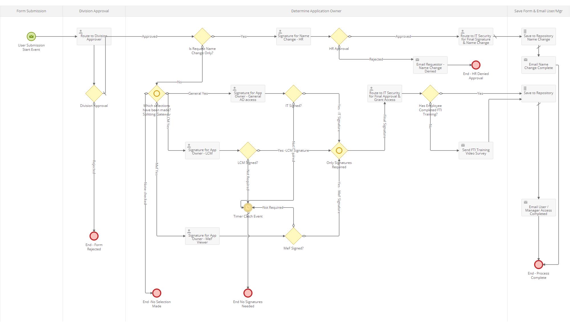

I think it would help to see an earlier part of the business process to see how it branches out and assigns the different signature tasks.
replied on December 5, 2019 Show version history

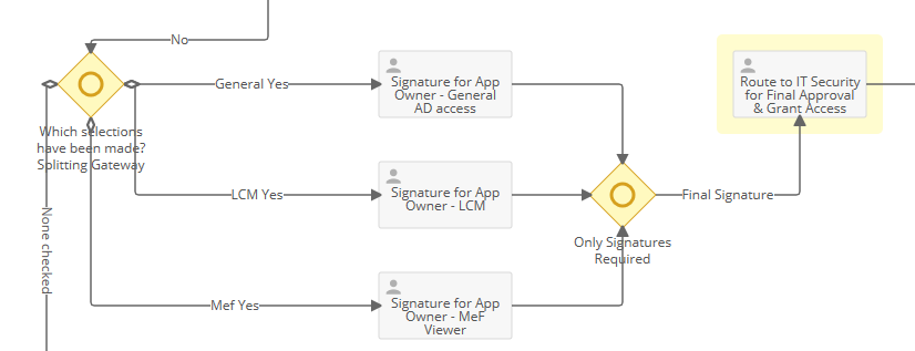

Here is a larger view:

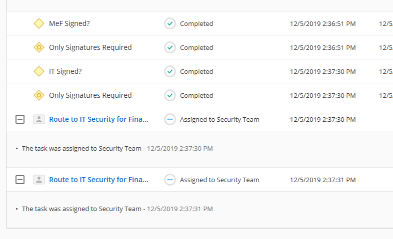

When one is selected it works fine and when all three are selected it works, but when only 2 are selected it sends two emails.
Which email is coming twice? Were you also getting duplicate tasks?
What is the purpose of the "not required" branch after the signatures? I would have expected the task not to even occur if signature wasn't required.
I'd suggest taking a closer look at the instance history for one that only required 2 signatures to see what activities occurred and in what order.
The Route to IT Security (Final Signature) is getting two emails after the Only Signatures Required Exclusive Gateway, when two signatures are needed.
As for the "Not Required" branches, I thought I needed a No branch to go with the Yes branches and haven't thought through that piece yet. It should really never get there unless the approvers are out of the office and it hangs up while waiting for a signature mode.  Suggestions?
Yes, on duplicate tasks as it shows up twice in the inbox. Is that what you mean?  Sorry, I'm slow replying I've looked at this all day and tired

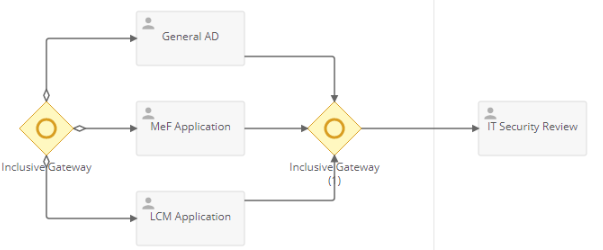

I made the changes you suggested and Wow!! I was trying to make it more complicated that it needed to be.  It worked!!!!!
Thank you Jason I really appreciate your help!  This was only my 2nd form to create.  The gateways were confusing me, but I think I have a better understanding now.
Below is how I changed it:
I appreciate all of the input received on this question! It always helps to get another perspective on things after staring at it, over and over.  THANKS!!!!

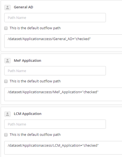

replied on December 6, 2019
Yes, in the inclusive gateway you should have a rule for each of the outflows to determine which of the branches are to be followed.
From what I read above you have 3 outflows based on the Application access selection :
Application access selection=General AD
Application access selection=MeF Application
Application access selection=LCM Application
In the example below I used a Checkbox selector on the form to choose Application Access
That is correct, the merge inclusive gateway requires no rules. It is just listening for the appropriate paths to be completed
