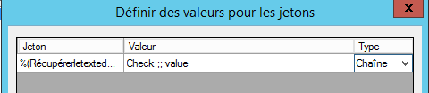

Using Workflow, I'm trying to substitute all ";;" by ";-;" but my result is strange
 When I'm trying the function, the result is not what I want.
Result
This should be "Check ;-; value" and not "Check , , value".
What's wrong?

replied on December 4, 2019
Hi Olivier,
I think it should actually work fine but the test is misinterpreting the semicolons (;) as separators. For me, when I test with type String and check the Exact Input box, this works.
You can be extra sure that it does work by running a test workflow with a hardcoded token and tracking the tokens as they are produced by the substitution in the Token Calculator.
