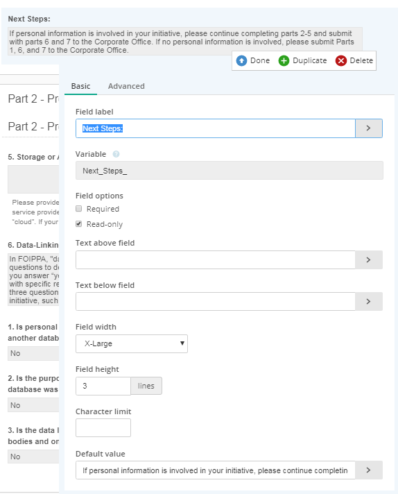

I have searched through answers and tried multiple ways, but I can't seem to change the background colour of a read-only text field to white. This is what I have tried (amongst others):
any suggestions would be much appreciated.

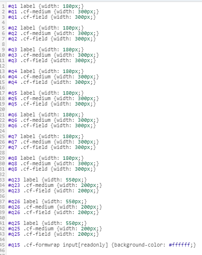

The following works for me
.cf-formwrap input[readonly] {
background-color: #ffffff !important;
I don't know what I'm doing wrong, but it's not working for me. Thanks for the response though.
Do you have any other CSS that may be interfering?
Also, is it set as read only at the field level, a section, or the entire form/task?
This is my entire css for this form:
It's set to read-only at the field level.
Should I be using a field other than "multi-line"?
Ah, that would be the issue then. A multi-line field is perfectly fine, especially since you obviously need the space, but it is not an "input" element.
Change "input" to "textarea"
For reference:
Radio buttons and Checkboxes are also inputs, but they're a little more complicated.
On a separate note, it looks like the text is just set with a default value. If that isn't actually a field that will ever change from user inputs, you could just use custom HTML; that would remove the need to override default field styling and would also cut out an unnecessary variable.
Inside the customHTML you could do something like
<label>Next Steps:</label><p>YOUR TEXT HERE</p>
Definitely switching to HTML - thanks! This fixed it and looks much better.
