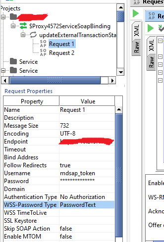

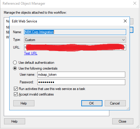

please note that we have fixed the issue of the web service, from the SOAP UI.
the web service takes username and password which i have configured in the web service properties in the workflow as follows :
but i have an issue now, in soapUI i configure the wss-passwordtype to PasswordText as follows:
please advise how we can reflect this is the workflow activity.

replied on December 26, 2019
Please don't post the same thing in multiple threads.
As discussed in other threads on this site, Workflow's HTTP Web Request activity does not support SOAP web services. The best way to support SOAP web services in Workflow is to create a custom activity that consumes the SOAP service (through the add service or web reference functionality) and generates the code to produce and parse the SOAP envelope and response.
