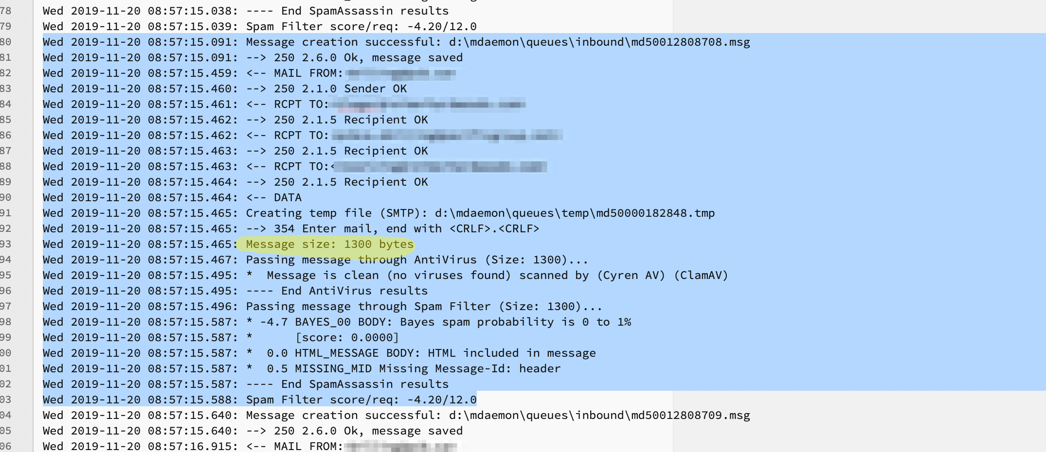

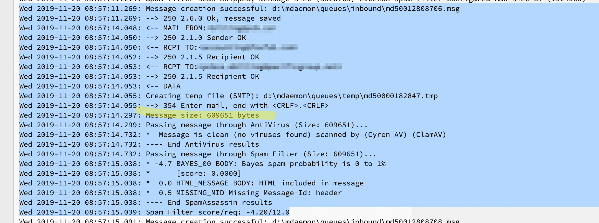

I have pulled the logs, SMTP-IN log snippet screenshot - working and not working, meaning has attachments and does not have attachments - note the email size.
The email coming from Workflow is 1300 bytes, this is too small - it has no attachment.
A working email with attachment:
Wed 2019-11-20 08:57:14.055: Creating temp file (SMTP): d:\mdaemon\queues\temp\md50000182847.tmp
Wed 2019-11-20 08:57:14.055: --> 354 Enter mail, end with <CRLF>.<CRLF>
Wed 2019-11-20 08:57:14.297: Message size: 609651 bytes
Email that should have an attachment:
Wed 2019-11-20 08:57:15.465: Creating temp file (SMTP): d:\mdaemon\queues\temp\md50000182848.tmp
Wed 2019-11-20 08:57:15.465: --> 354 Enter mail, end with <CRLF>.<CRLF>
Wed 2019-11-20 08:57:15.465: Message size: 1300 bytes
