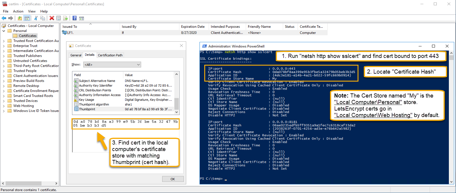

I expect you would use netsh, but I don't have specific instructions. If you haven't seen the documentation for how to set up the cert in the first place, you may find it helpful.
replied on November 13, 2019 • Show version history
Stephen,
To expand on Brian's answer: if you have IIS installed on your internal server with LFS, you can check the certificate bound to port 443 in IIS. LFS uses the same cert. If you don't have IIS on the LFS machine, you can do the following:
