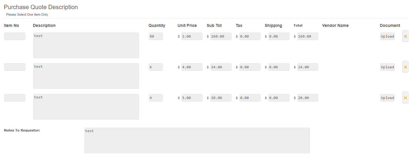

Form 1 Review. 3 rows

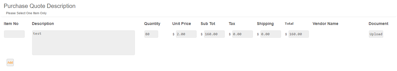

Form 2.  I Remove 2 rows to only have 1 row
Form 3 Final Review. The 2 rows from form 1 is now back on this form

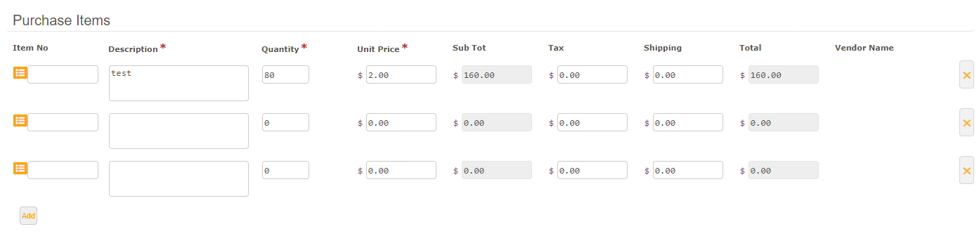

Hi Maxwell,
    I created a similar process based on the screenshots attached, to reproduce the issue, I need to have different number of columns in the table on form 1, form 2 and form 3:  there are more columns in table on form 1 than form 2, for example, 3 columns on form 1, then 2 columns on form 2 when rows are deleted, then on form 3, it will show the rows deleted in form 2 as the columns not displayed on form 2 still have values.

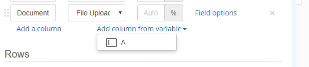

   Please confirm whether your process have same situation: the table in Form 1 has more columns than table in Form 2, you can change Form 1 and Form 2 to have same columns in the table to avoid this issue, you can add column from the variable to add the missing columns on Form 2:

So I made the table on all forms to have the same columns. First form is the entry form where you can add multiple items(rows). Second Form is the review form where items(rows) can be deleted. Third Form is the final review Form where it shows the items(rows) from the First Form even if the items(rows) was deleted in the Second Form.

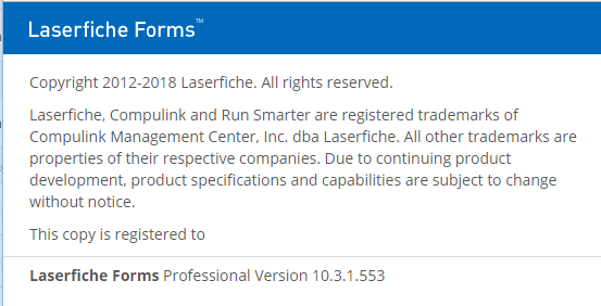

replied on November 12, 2019
What version of Forms are you on so we can test it?
6.3.6
replied on November 14, 2019
10.3.1.533
