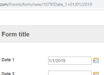

replied on November 10, 2019
I used chrome and fire fox, but should be compatible with any browser. I was also using an on premise installation, but the parameters should be the same on the cloud. I used Date_1 as the variable name.

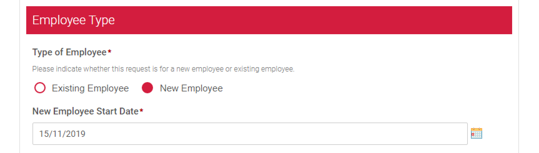

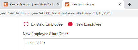

Bit of a strange one this.. here's some additional insights:
As you can see the New Employee is passing but the date isn't. The date by itself also doesn't work.
replied on November 14, 2019 Show version history
It looks like you're passing in November 16th, but the field is populating with Nov 15th, is that correct? You may need to open a support case for further investigation. This is working for me on all my local tests.
It's possible that there is a mismatch in your browser location and you form server location and it's doing some time zone adjustment causing the date to be one day off. That's a guess though. I might be able to help more if you have a few more test cases. Is it always one day off? Or is the 15th a default value? Is there any other lookups or calculations acting on the field?
Also try using the date format 11/16/2019, see if that works.
