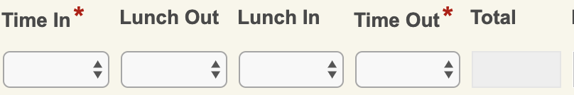

I am trying to calculate my total hours for the day on a table in a given row.
I am using the value of seconds in the day for the calculations.
There are two cases, IF Lunch_Out / Lunch_In are empty I just need to calculate (Time_Out - Time_In) for my total hours.
ELSE calculate (Lunch_Out - Time_In) + (Time_Out - Lunch_In)
Here would be my result calculation from this:

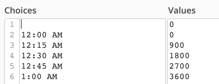

I am not sure where my logic is missing any pieces.  If a dropdown choice is not selected, is the value truly BLANK?  Wondering if the ... = "" is what is not working correct.  I added the value 0 to see if modifying the logic to the following below would help.  But it did not.
=IF(INDEX(tbl_timecard.Lunch_Out_Dropdown, ROW()) = 0,  ....
NOTE:  If it would work I would most likely modify it to a value that would never exist in the dropdown value choice.  Since 12:00 AM = 0 already.
