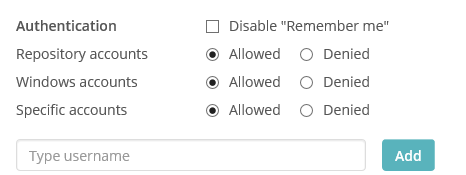

replied on January 9, 2020
Hello Hui,
If the "Remember Me" function is not turned off is there anything else that needs to be done for this to work properly. We do not see any option when logging in to select "remember me".
Regards,
Hi Drew, can you please clarify what you refer to by "this" (in "for this to work properly"), because there have been two topics being touched upon in this thread, one is the session timeout, and the other is "remember me". "Remember me" functions within the "timeout" framework. thanks,
Hui,
I'll add to the thread since we are the client for Drew, 'This' is the 'Remember me' function. In Mobile Server Configuration under Authentication we have "Disable 'Remember Me'" unchecked which would imply that 'Remember Me' would be active.  The odd thing is that when we are logging in to Mobile via the app there is no 'Remember Me' function that we can see.
Ultimately what we are trying to resolve is our users having to reauthenticate over and over in the Mobile app every time they fire it up.
Thanks for your input.
replied on January 9, 2020 Show version history
Hi Collins,
You spot on, currently the "Remember Me" activation control is through the server configuration page for all your users. It's a centralized control, and you users won't be able to change it for themselves.
As mentioned in my previous comment, "Remember Me" takes effect within the Timeout settings. For example, if the timeout is set at 5 minutes, your users can go off and come back to the app within these 5 minutes without repeated sign-ins. But if the user comes back after 6 minutes, the login credential will expire and he/she will be required to enter user name and password again as a security measure. You may want to check your timeout setting on the mobile server configuration page.
