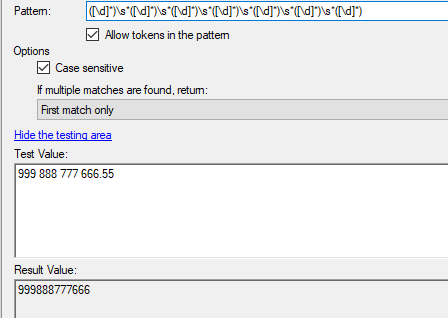

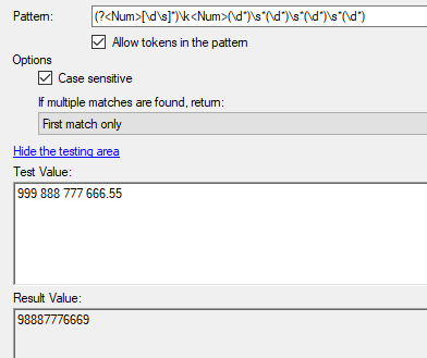

replied on October 31, 2019
Hi Dustin,
Thank you for the info and detailed explanation on how it is put together. This really helped.
There seems to be some weird behaviour though when using the suggested regex. For some reason, this regex does not like it when the first 3 number are 999.
See below:
So I opted to go for a variation of Michael's post, which seems to do the work.
See below:
Really appreciate the assistance and info.
