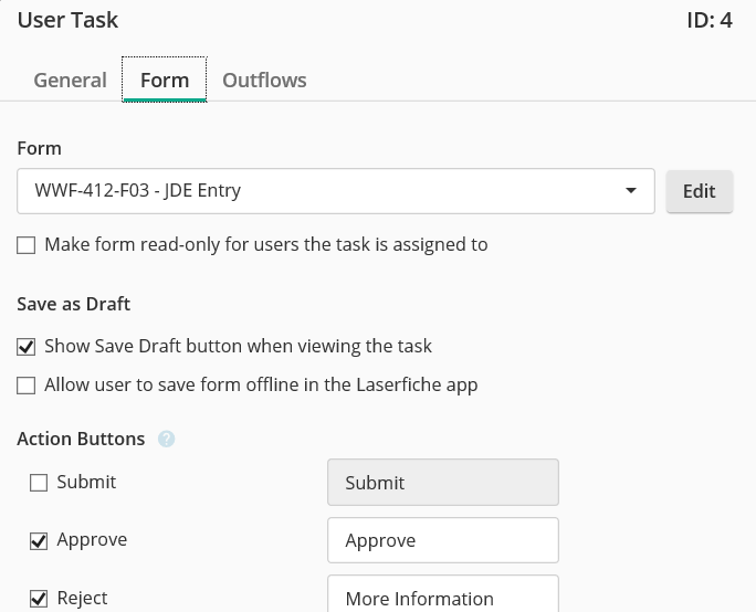

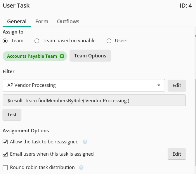

Brian, having both forms in your business process and sending the notification to the supervisor via task assignment email should work.  What version of forms are you using?
Make sure to choose the option "Email user when task assigned" in the General tab and choose your second form under the Forms tab.  This should send the link that will open the task for the user.

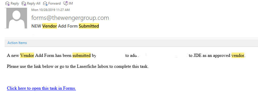

Brian,
In 10.2 the email should include a "Click here to open this task in Forms" link at the very bottom that will link to the user task.
In 10.4 they added the ability to customize the location of the task link, but it should still be in the default location for the previous versions of Forms.

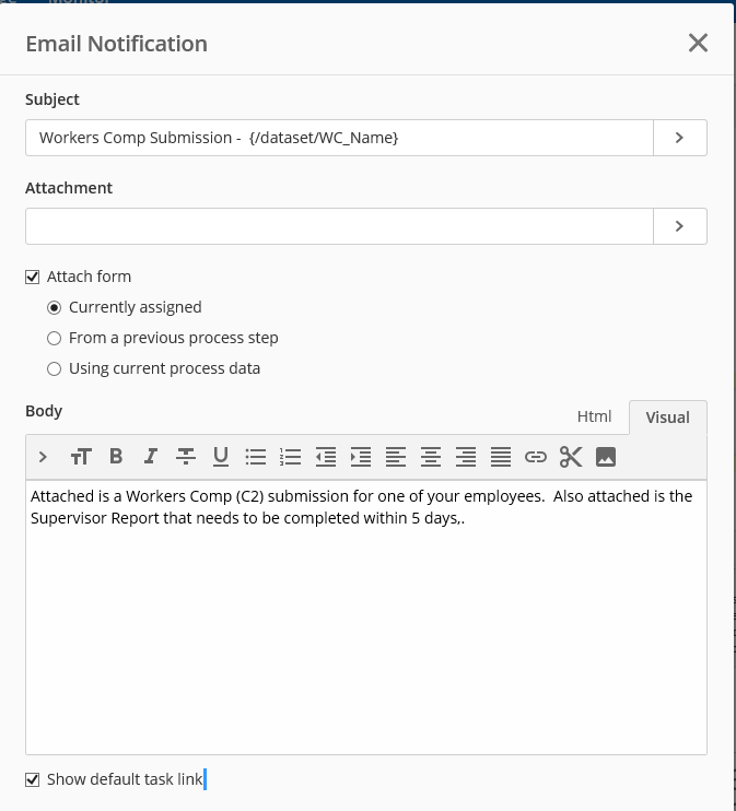

It comes down to the email message sent to the super that there is a form to complete. It doesn't put any link in. There is a box on the bottom you can check Show default task link      but this just opens a prompt for username and password to log into forms. Any attachment included is non-interactive and no link is automatically generated in the email.

The default task link will not show up when you're configuring the email, it will only display when the email is sent.
If they're getting a login prompt when they click the link, then either SSO is not enabled, or the browser is not passing the credentials to Forms.
If they log in when following that link, it will open the task; this is the same link, but you have to be logged in to complete the task.

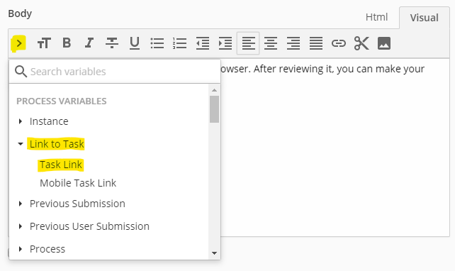

10.4 allows you to put the link anywhere you want using one of the variables (if you click the ">" button at the top right of the email editor you can add the variable that will include the task URL).
However, I'm not sure what the expectation is on the part of the director. You cannot complete an assigned task if you are not logged into the system. Either you need to enable single sign on (SSO) to automatically log the user in, or they will have to log in manually.
The bottom line is that you have to be logged in to complete a task.

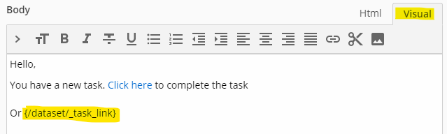

The task link would not go in the subject, and attachments are only for file uploads as you cannot "attach" a link to an email, only files.
The "gibberish" you're referring to is likely either the variable itself, or the unique identifier that is attached to the end of the URL; this unique identifier is what tells Forms which task to load.
If you drop the variable directly into the "Visual" portion of the email editor, it will appear as a variable but will be replaced by the URL in the email.

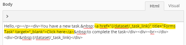

The "cleaner" option is to edit the HTML and insert the variable into the href attribute of an anchor tag (link) so you can have custom text in front of the link.
In either case, the resulting email will then contain the URL for the associated task.

In my test I just receive the message as displayed
Attached is a Workers Comp (C2) submission for one of your employees.  Also attached is the Supervisor Report that needs to be completed within 5 days,.
(which this is incorrect and needs changing)
Attached is the starting form submitted by the employee but there is no click here
as a link to the new form and I did the variable as you have it but it came up in the message just like yours but inactive when I copied it into a browser address bar it failed
And I'm trying to make a case for combining multiple forms into one process when they all involve the same end goal. So far its not going well. Currently there are 3 processes with 3 forms to handle one issue.
When I talked to our provider I stated earlier that they did not know of anyway to accomplish it without checking the bottom box and forcing them to login to forms.
If I check the show default task link it does put the link in but when clicked it forces the login. I believe it is necessary to check the box to get the link but since they will have to login this is the end.
