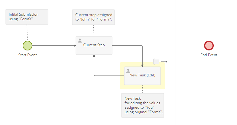

Sorry - to correct myself, it is very possible for a platform administrator to update the information after it has been submitted. Although the process to do so is very convoluted and should only be done while the business process is unpublished.
The way to do it is to:
1) Unpublish the business process.
2) Using the Monitor view, find which step your targeted submission is currently at. You'll need to know this so you can target it in the business process. Note: If the "current step" is quite an advanced form or has special lookups/dependencies it may not be possible without a lot of additional work to submit that form.. so be mindful of this before proceeding.
3) Now that you've identified which step you need to target, open the process modeller and add a new user task to the process which is assigned to you (as the platform administrator - important since unpublished processes cannot be completed otherwise).
4) Now configure which form will be displayed to you when you open the task. You do this by selecting a form in the new user task (such as the original form). You can alternatively build a simple form with just the fields you wish to edit. Depends on how much effort you want to go to in order to fix/update/edit this data.
5) Connect your new task to the current step in the process. Loop the ouput from the new user task back into the original step. This way when you complete your user task it will loop back into the original "current step".
6)  Now go back to the Monitor view, select the current step task, assign it to yourself. Complete the task so that it moves to the "New Task (Edit)" that you have set up. You have now been assigned the original form as a task which you can edit/update and resubmit. When you submit this new task, it will loop back to the original step and place the task back onto the original user.
7) Now don't forget to edit your original process, reverting back your changes. Also don't forget to publish the form so that is available to others to use.
Not a lot of platform administrators will want to go to these lengths to get this to work. It also depends on whatever step the process is currently on.
