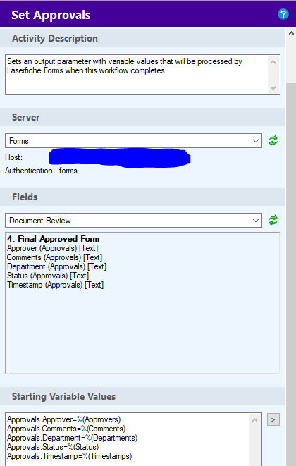

Here is what I have tried:
  • I checked the forms process to ensure it is calling the correct workflow, which it is
  • I validated that the Retrieve Business Process Variables and Set Business Process Variables steps were all set to get the fields to interact with from the correct forms process, which they were
  • I re-ran the workflow and monitored it's progress.  It ran as designed with no errors or messages and the expected token metadata was populated.
  • I re-did the starting variable values in the Set Business Process Variables step to ensure these hadn't changed with the copy, and ended up with the same starting variable values.  Re-ran in case it was a misplaced space or the like by accident, but got the same results. (Picture below)

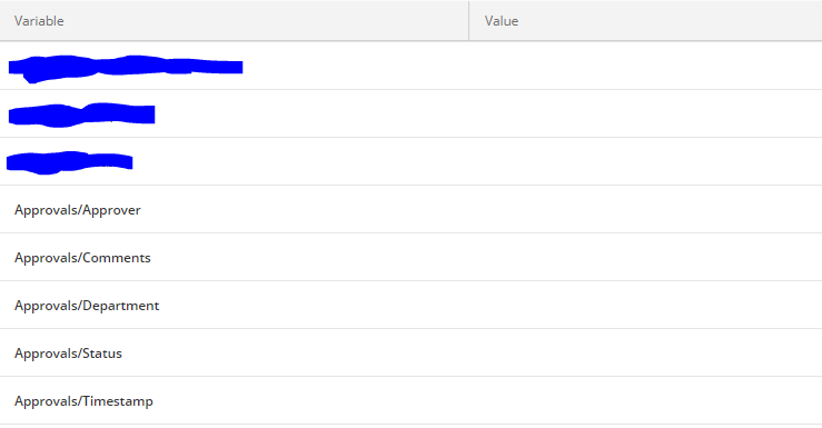

  • I checked the monitor for the instance of the process, and looked at the variables.  None of the variables the Set Business Process Variables step was supposed to set had populated. (Picture below)

Ok, so our IT Manager and I have been digging into this today.  Here is what we have found:
In the last entry of the tokens for the workflow, we see a deltavars which is showing that workflow is setting the attributes 4429-4432 (or something like that).  these attributes do not exist in the forms process we are using, but rather the one we copied it from.  While we did make the correct changes in workflow, this step got hung up and never actually reflected this change.
Our solution was to re-create this step from scratch, thereby selecting the correct forms process from the get go.  Once we did this and disabled the old step which was hung up, everything ran without a hitch.
