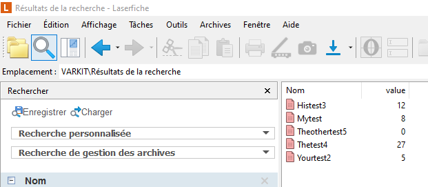

From my Windows Client, I created a quicksearch files based on the name "*test*".
This search return me 10 results (Mytest, Yourtest2, Histest3, Thetest4, Theothertest5...)
Now, from a Workflow, I wish to get a report from this result.
How can I do?
Thanks in advance.

Hi all, thanks for your help.
@Bert Warren, the search is not always the same. In my example, the user wrote "test" but he can wrote anything and get more results. This is why I wish to get the results or the %searchterm in my workflow using a business process.
@Steve Knowlton, you right, I can use Download Report to get a report type Excel but what I want is to get the report AND a sum of values (a total line at the end of my report).
