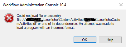

Hi Paul @████████ , I am also attempting to build a custom activity in Visual Studio 2019 using the provided Visual Studio 2010 templates.
I have changed the assembly framework to 4.5, and it is building fine, but I am getting stuck importing the custom activity using the workflow configuration manager - I keep getting the message "An attempt was made to load a program with an incorrect format."
I have tried building in x86, x64 and Any CPU, and I tried removing the references to Interop.LFSO90Lib.dll and Interop.LFSO83Lib.dll, but still not working.
Have you had any luck with linking your custom activity? If so, please let me know how you managed it.

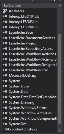

replied on May 19, 2021 • Show version history
Hi there, I had the same kind of issue and found it was due to my library references.
I added Interop.LFSO104Lib manually as only nterop.LFSO90Lib was referenced by the template.
Then from your class script(.cs) add using LFSO104Lib; and remove any other using LFSOxxxLib
frown  Hope it helps
