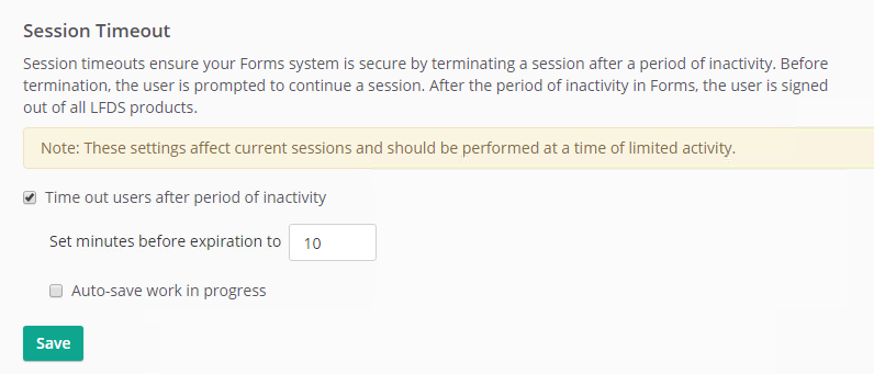

Forms Configuration, User Authentication, at the bottom
replied on October 18, 2019
Hi Steve
I saw this option, but we do not have this checked. We are looking for the master timeout, the one that overrides this and usually lasts about 1 week of time. It used to be under the <forms tag but it has gone missing.
This Forms installation is logging users out every 30 minutes or so, so we need to find that master config and put it back to 1 week.
