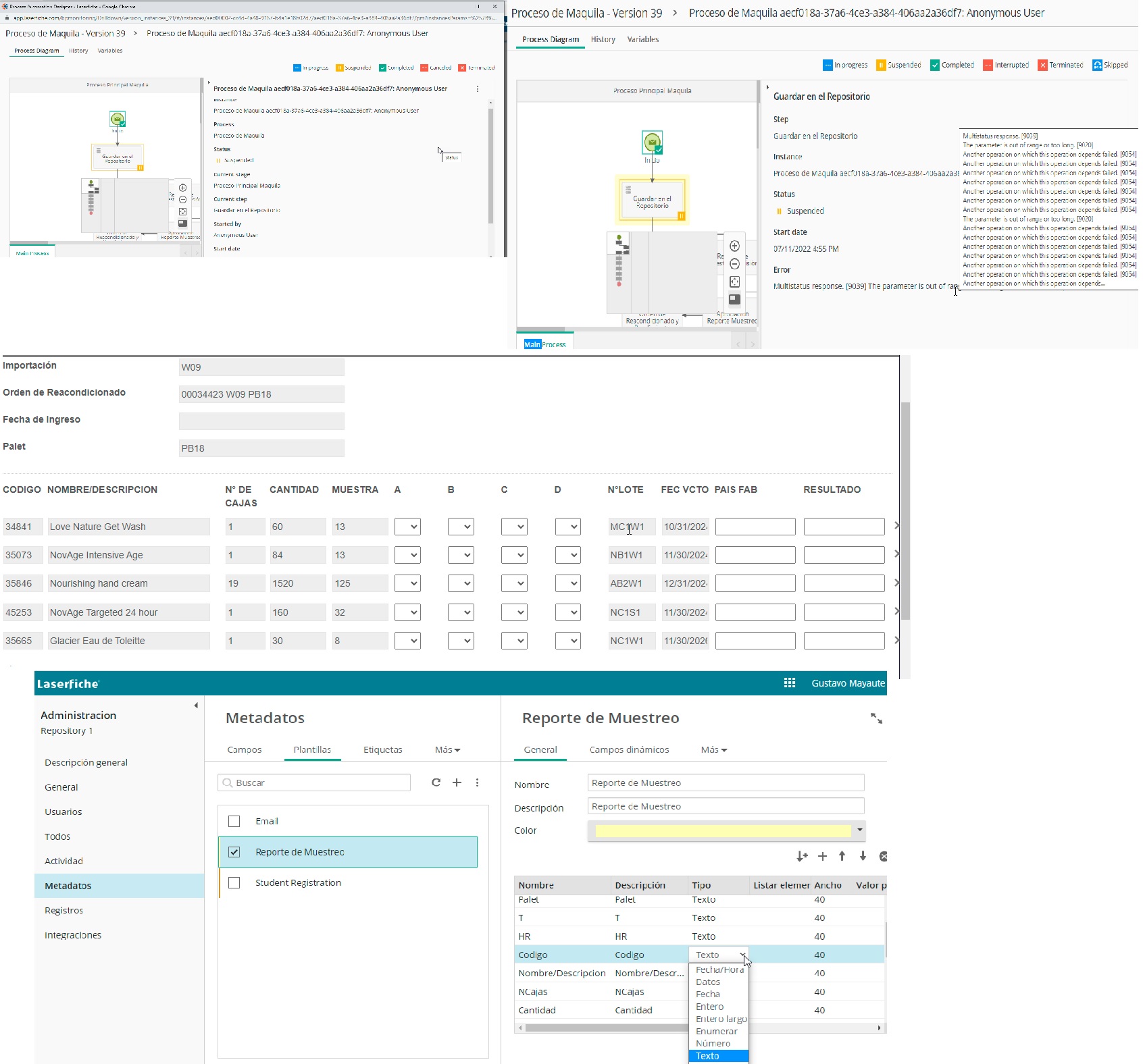

I have a similar problem, I am trying to save the information of a Form in a repository (it has textbox and multiple Tables),
For which I have created a metadata template, each field configured with each data type.
But when selecting "Send" the Process Automation comes out in "Suspended State", reviewing the error log, I found that I have problems
with the fields (attached the image), which may be happening.
I am assuming that I have misconfigured the data type of the Metadata template, in the case for tables.
First of all, I thank you for your support.

Hi @████████, apologies for the delayed response. I completely forgot to get back to you.
From looking at your message:
The parameter is out of range or too long. [9020]
Another operation on which this operation depends failed [9054]
Another operation on which this operation depends...
The message is cut off, so I cannot see if there are any other problematic fields, but the lines that have the 9020 error indicate which field actually had the issue, there the ones with the 9054 error indicate fields that are fine. From counting the lines in your error, I can see that field 1 and 9 have the error "The parameter is out of range or too long. [9020]"
This error means that the value from the form is either longer than the size of the field, or that the field type is incompatible with the value, or that the field has a constraint that the value is violating. I'm not sure which fields are 1st and 9th in your Save to Repository action, but you will need to check those fields and the values attempting to be saved and make sure the field is large enough to fit the value and is a compatible type. For example, if you have a Number field, and the value being saved is "ABC," it will not be able to save the field because ABC is not a number.
I hope that helps you if you are still having trouble with this.
