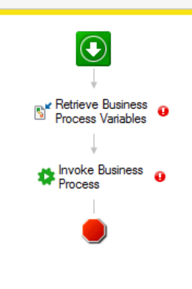

So, in the workflow you'd call from Forms you'd Retrieve Business Process Variables to bring the field data from the Forms process into Workflow tokens then use Invoke Business Process from Workflow to start a new process. That activity has the ability to set process variables in Forms when it launches.

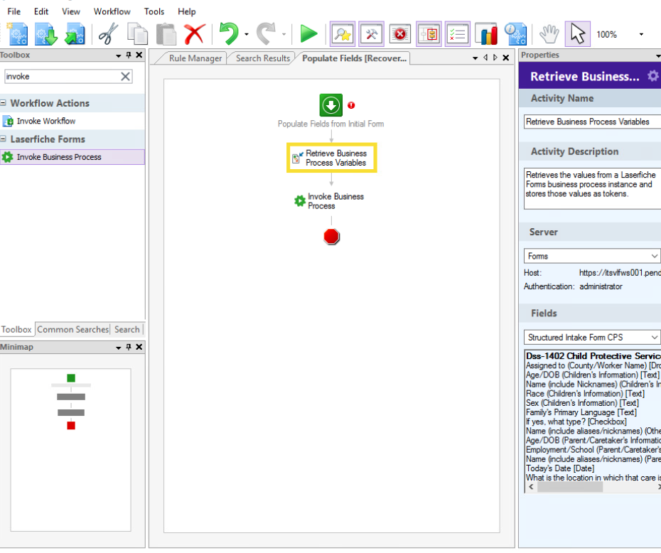

Thank you Jeremy! I was on the right track but you've helped tremendously!
So I figured out the Server section for Retrieve Business Process Variables, but now that we've found our variables and turned them into tokens, how do we put them into the other form..? Is that under the Invoke Business Process somehow?
replied on October 25, 2019
Yes it's in the Invoke Business Process. If you click that activity and in the same area as where the Fields are listed in your screenshot you can add tokens to map to variables in Forms. I would use the Help section for that activity (top right ? icon) to get the specific syntax for how to craft it but you can specific there.
