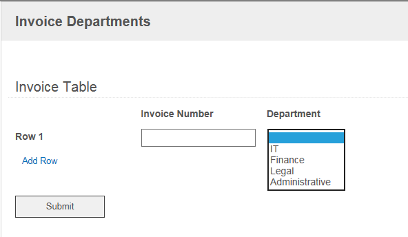

I created a Form that includes a simple table, with columns for Invoice Number and a drop-down column for Department:

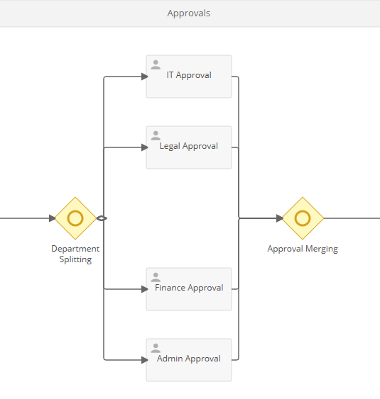

Then, built my Process Diagram to use an 'Inclusive Gateway' to split into the necessary paths:

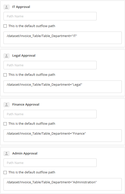

I then configured the 'Department Splitting' gateway outflows to be based on the Department selection in that table:
NOTE: the variable will differ in your process based on how you specifically configured your variables

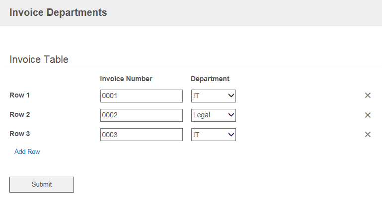

I tested by submitting the Form with 2 departments in the table:
...and the Form was routed to the appropriate 2 approval parties (the 2 unused remained inactive). The second 'Inclusive Gateway' (Approval Merging) waited for both approvals to be completed prior to moving on with the process (no special configuration needed there).

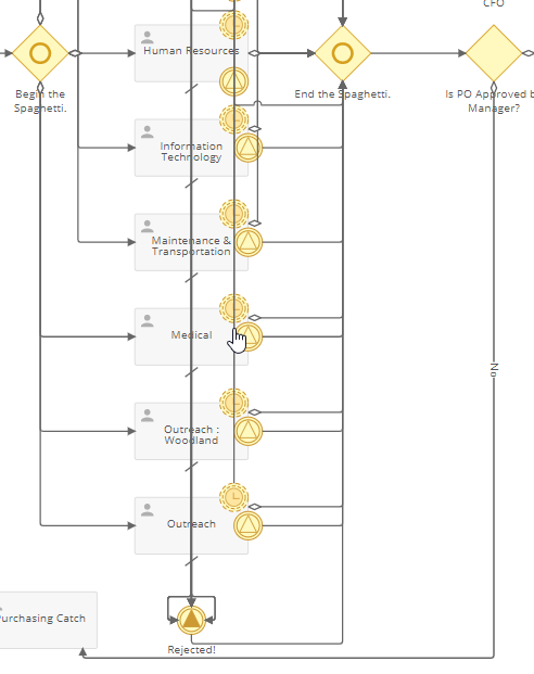

Here is what I ended up with.
So each User Task has two Outputs, Approved and Rejected, Approvals move on to the "End of Spaghetti" activity and waits patiently for all other User Tasks to get there.
However, should a user opt to Reject the form several things happen;
The Reject Outflow triggers and hits the Rejected Signal Throw, which prompts all Rejected Signal Catches to kill their respective User Tasks. Each of the Singal Catches then runs to the "End of Spaghetti" Activity because Inclusive Gateways can see exactly how many responses it SHOULD get back and if we terminate the User Tasks without anything extra the whole process stalls as the Inclusive Gateway will wait on responses it will not get. The Catches here will solve this problem for us.
Some JavaScript runs and fills in a "hasBeenRejected field.
$(document).ready(function(){
    $('.hasBeenRejected input').val('');
  $('.Reject').click(function(){
    $('.hasBeenRejected input').val('Rejected');
This will allow my "End of Spaghetti" Activity to run the "Rejected" Outflow and send the rejection back to the Submitter for either restart the process with any fixes listed in the Comment Section from the rejected User Activity or to cancel the process and let it end.

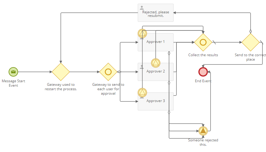

I deleted the old one so I remade it real quick, this is the most basic functioning one I can make at this time.
When a user rejects the Form it sends a response to the "Someone rejected this" Signal Throw which triggers the "Rejection" Signal that all 3 of the attached Signal Catches are waiting for, they cancel the current task and then send *something* to the "Collect the results" Gateway so it can move on. "Send to the correct place" Gateway uses the standard outflow "Last User Action = Reject" and a Default path. Of course, the Default path can move on to other stuff but I have it end there. Since the last user action will always be "Reject" in the event of rejection it will send it off to the initiator with an email that houses the "Comment" from the rejector explaining why and then the initiator can fix and resubmit.
"Gateway used to restart the process" exists solely because the "Rejected, please resubmit" User Task can't route to the "Gateway to send to each user for approval" since they can't typically have multiple inputs and outputs so a secondary gateway is used to fix this. I just tested it as well and it seems to work according to plans.
Of course, you can add a bunch of other stuff but this is as simple as I can get it.
