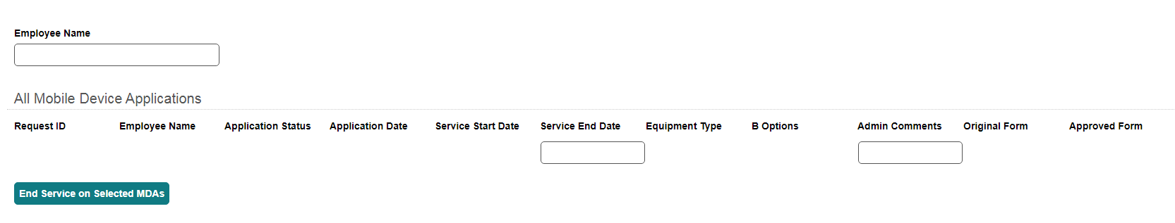

I have a form with a table populated from a Lookup rule and a single field to filter the Lookup.
Here's the Lookup:
Here's the store procedure I am using for the Lookup:

As you can see in the SPROC if there is no value passed for the parameter @EmployeeName it will default to empty set and in the Where clause if @EmployeeName is empty then it should return all rows.  However, you can see in my screenshot the table is not populating when the the Employee Name field is empty.  I tested the SPROC in SSMS with nothing in the parameter and it does return all rows.  My question is what does Laserfiche Forms send as a parameter if the Employee Name field is blank?  If I put a default value in the Employee Name field like my name then the Lookup populates the table with all rows with my Employee Name but I want the table to populate with all rows to start then only filter for Employee Name once a name is typed into the Employee Name field.

replied on October 9, 2019
I'm not sure the lookup will fire at all on from load with a blank value in that field. If you add a value to get results, then delete it, you can see if it returns the "default" set.
If the problem is that it just isn't firing on load when blank, then you could try adding JavaScript that runs on document ready and "manually" triggers the change event if the field is empty.
