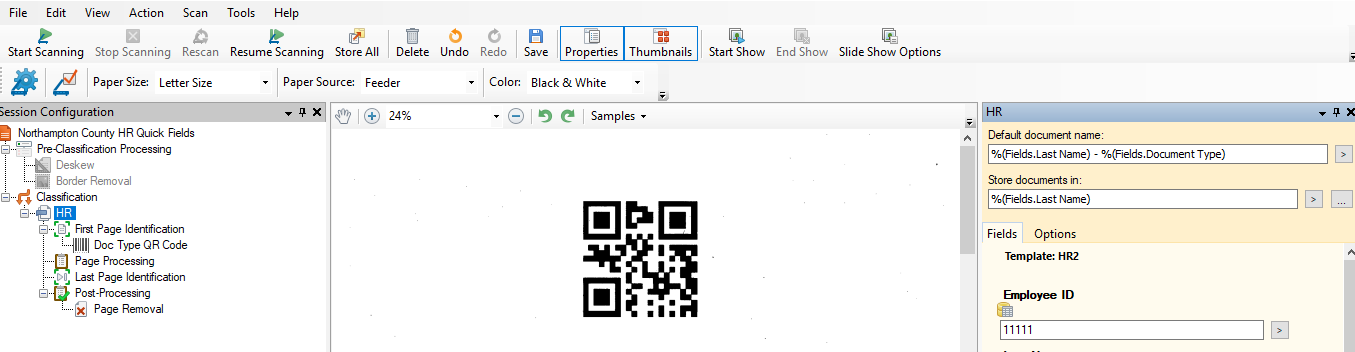

I am having trouble using a token value to set the file name and directory path in a Quickfields session. I am using a lookup value to pull in Employee Name, DOB, Hire date using Employee ID. I then am trying to set the file name and directory by Employee ID.
My thinking is that the lookup is occurring after the setting of the file name and directory but I don't know how to correct that.

What exactly is the trouble? The configuration in the screenshot looks fine (except for the fact you'd be creating the "Last Name" folders off the root of the repository which is not exactly best practices).
replied on October 4, 2019 Show version history
Yes, my mistake it is set to last name. When I go to save it, the last name is blank followed by Doc type. So the file name is "- New hire" for example.

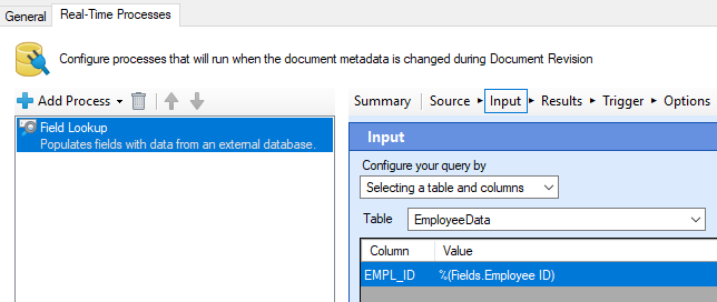

How is your lookup set up?

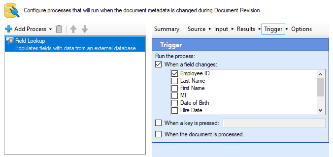

What is triggering your lookup?
If you click on the document before sending it to Laserfiche, does the Last Name field have a value?
I am triggering the lookup in the real-time processing at the document class level. Should this be done at post processing?

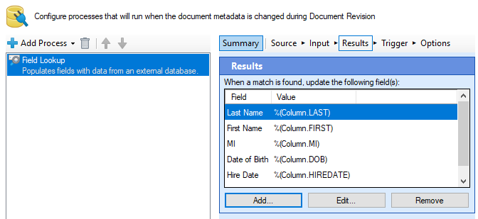

What value are you using to trigger the lookup? Is it a field or is it a process token and that token is blank for this document? Can you post a screenshot of your lookup configuration?
Here is the way I have it setup.

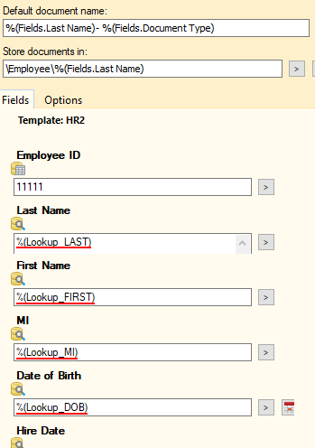

When the documents are scanned, I enter the employee number (11111 in this case) and it returns all the values. The document name never changes to the value of the token.
It looks like you used to have a have a Lookup process and still have the tokens in the field. You should clear those out.
When you use a field lookup, the tokens in the name will not update (this is by design in case you want to re-run the lookup before sending the document to Laserfiche). The name should be set correctly when the document is sent to Laserfiche though IF the corresponding fields have values at that point.

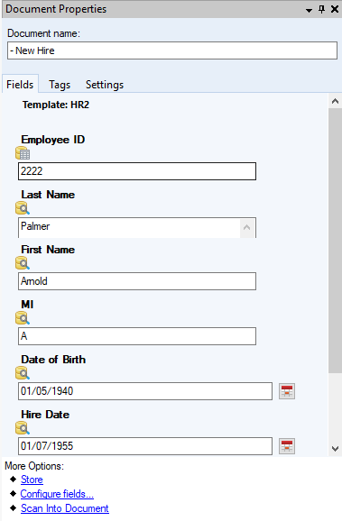

When the documents are scanned and I enter the employee number, this is the result. If you notice, the Document name is missing the Last Name value.
So, you are saying a second lookup should be done when the files moves to Laserfiche?
