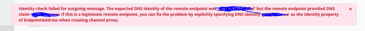

I have configured the LFDS by getting the host name which is a .local domain.  Our SSL cert is a .ca I suspect this might be an issue.
but I did get this error message ( attached ) is there a way to configure forms to set the DNS identity ? I wasn't sure in which config file and in which section this could be done.

replied on October 3, 2019
I found the Directory Server Single Sign-on PDF guide and at the bottom it explains how to resolve this.
I had to add the identity in both the /Forms and /Config Web.config files and now the DMZ forms server user authentication works.
