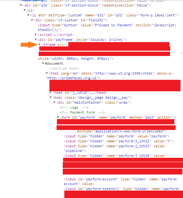

replied on September 27, 2019 • Show version history
Can you show me a screenshot of custom html containing the iframe?
replied on October 10, 2019
Sorry for the delayed response. I wanted to make sure that I wasn't exposing anything proprietary and I'm not sure how helpful this type of screenshot might be. Please let me know if there's anything in particular that you're looking for that I may be able to provide.
When you say it doesn't work, are you saying that you are not getting the alert?
Can it be that the iframe loaded before the document is ready?
What if you put this outside the $(document).ready(function(){});
$('#divname iframe').on('load',function(){alert('loaded')});
I guess it doesn't matter as long as the iframe is loaded. Anyways, I think it's more important you do below. Obviously your selector for iframe will be different since it doesn't have an id, but once you get the content, you can do something like innerDoc.getElementById('#id_of_button') and try to attach a click event listener and runs a function that does what you want.
